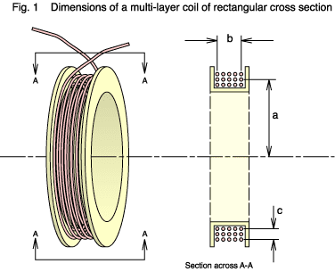

What is the difference between a coil and a solenoid? (I'm asking the question seriously).
For this problem:
COIL
Solenoid
In general people may (and will) say "coil" for the second case too.
Did you consider using the mutual inductance of the coil-solenoid system?
I have a theory question for you that might help to get you started on this problem:
What special characteristic of Mutual inductance helps us to quickly and easily solve problems like this?
