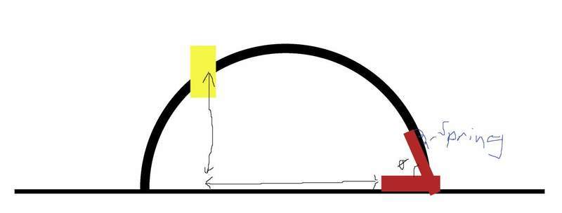

We had a lab where we launch springs with an unknown k constant to a target 2.01m away and 0.22m high. We also know the angle at which we shot the spring.
We need to find the k constant of the spring, so my question is, does the kinetic energy matter?

How do I obtain the parameters required to determine the initial velocity?
The only values I have are:
- the angle
- the distance to the target, and the distance the target is above the ground
- the stretch (x) of the spring
The very first thing I need to do is get the K constant of the spring, so I can know how much force the spring launches with. However, to do this, I need the initial velocity of the spring, so I can use the formula: Eg + Ee = Eg + Ek
Am I supposed to cancel out the Ek somehow? Do i assume that the final velocity is 0, and use kinematics from there?
EDIT: The spring is indeed the projectile, and the mass of the spring is known.

Yeah, that link is handy, but the thing is, I don't have the horizontal range, we only know the distance to the target (distance to the fence in link)
Also, we don't know the time.
Here is a diagram of the situation. The arrows show the known distances.
C'mon guys, there has to be a way. . .
Okay, so I made a scale diagram to find the range. I used the formula to get the velocity using this range.
To check if this range was accurate, I entered the velocity and angle and range, to see the value for y, which turned out to be 0, which was expected.
Then i entered the value for x as 2.01m (the distance to the target), and y turned out to be 0.09m (which is the distance above the target!)
Therefore, the velocity i obtained is correct. Now I just have to do kinematics to find the highest height possible for y.
Okay, I found out how to do it algebraically, so I don't have to show my teacher a slightly inaccurate scale model.
Thanks a lot for that link, I now have everything I need!
