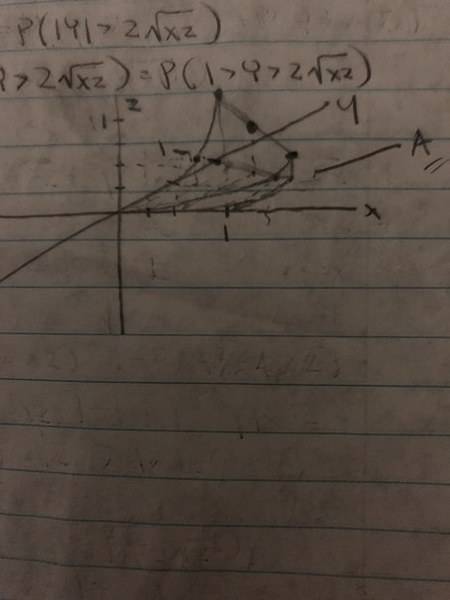

"Find ##P(Y^2>4xz)##, where ##(x,y,z)\in (0,1)^3##."
##P(Y^2>4xz)=P(Y>2\sqrt{xz})+P(Y<-2\sqrt{xz})=P(Y>2\sqrt{xz})=P(1>Y>2\sqrt{xz})##
Here, I set the boundaries for integration over this "wedge", for the lack of a better term.
##2\sqrt{xz}\leq y < 1##
##\frac{1}{4z}\leq x < ...##
I tried drawing a picture, but all I got from the information was that x could not be bounded by 0 or 1. The curve doesn't touch the any of the axes except at the origin.

well I don't think you stated that ##Y## is uniform taking values in 0,1 but I suspect that it is given that your post title asked for Volume...
Two other things:
1.) The issue in some sense is something seems missing. ##Y## is a random variable and so it presumably comes with a cdf and x, y are simply fixed values, apparently not random variables. There isn't any integration work to be done here if you already have the CDF. Just use the CDF of Y and then negate it and add one to get its complement. That being said, I have a hunch you want X and Z to be uniform random variables as well, though this is not stated anywhere
2.) In terms of pattern recognition this looks to be a touch different, but extremely close to this problem from October

Notation matters: I cannot figure out if you mean
$$P(Y^2 > 4 X Z)\hspace{4ex}(1)$$
or
$$P(Y^2 > 4 x z)\hspace{4ex}(2)$$ exactly as written. In (1), ##X,Y,Z## are iid ##U(0,1)## random variables, while in (2) only ##Y## is random.
If you really did mean (1), it is important to remember the distinction between a random variable and a realization of that variable. Random variables are typically denoted by upper-case letters near the end of the alphabet, while realizations of those variables are typically (but, of course, not always) denoted by lower-case versions of the same letters.
If you meant (2) the problem is essentially trivial, with a one-line solution needing no fancy calculations.

I'm not sure whether you finished your last exercise on right continuity of CDFs, but the thought that immediately comes to mind is a direct follow up to it.
conditioning on ## 4XZ = \alpha## for ##\alpha \in [0,1]##
what is ##P(Y^2>\alpha)## and what is ##P(Y^2\geq \alpha)##?
(hint: there are no jump discontinuities in the CDF for the random variable ##Y^2##).
The conclusion should be that the exercises are in fact probabilistically the same. I'd formalize this point via conditional expectations with two different indicator random variables, but the basic idea is zero probability of 'collisions' with continuous random variables.
