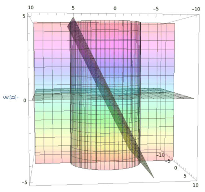

It might help if you can visualise it.
##y= \sqrt {25-x^2}## Is a horizontal semicircle radius 5, centred at the origin. In 3D, that as a boundary, combined with the y=0 boundary, defines an infinite vertical half cylinder.
z=0 is the horizontal plane through the origin, while z=x is a plane at 45 degrees containing the y axis.
These three boundaries enclose two separate wedges meeting at the y axis.
In one wedge, the z=0 plane is the upper bound, while in the other wedge it is the lower bound.

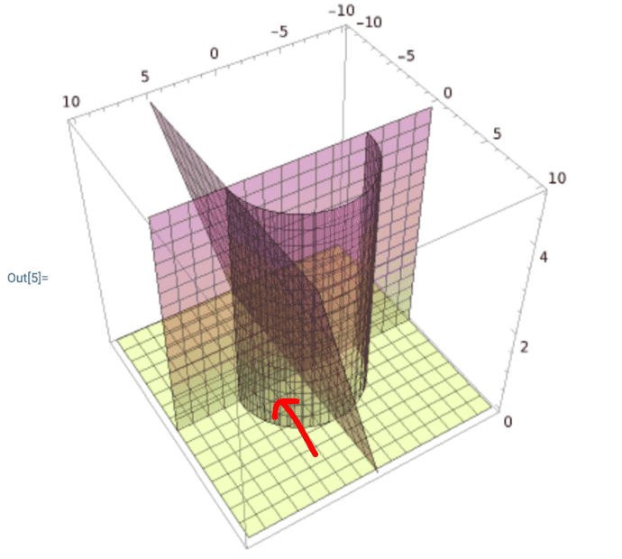

Mathematica 3D plot showing a vertical cylinder, a horizontal plane near z = 0, a tilted plane cutting diagonally through the cylinder, and a vertical wall-like surface, with axes labelled 10, 5, 0, -5, -10.

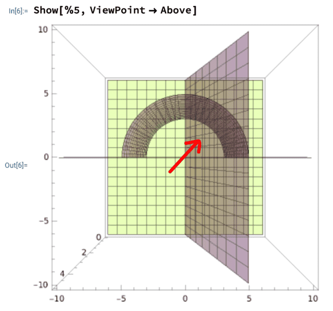

3D plot of a half-annulus (upper half of a ring) lying in the xy-plane, with a green grid plane and a purple slanted grid plane intersecting it, axes labelled from -10 to 10 and z from -10 to 10.
Alternatively, you can use integration under polar coordinates:
$$\int_0^{\pi}\int_0^5 | r\cos \theta \, r | drd\theta$$

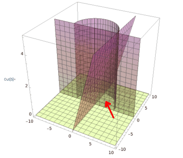

  • 3D Mathematica plot of a solid bounded by a vertical cylinder, two vertical planes and a slanted plane above a flat yellow-green base in the xy-plane, with a red arrow pointing to the base near the cylinder.
$$\int_0^{\pi/2}\int_0^5 r\sin \theta \, rdrd\theta$$

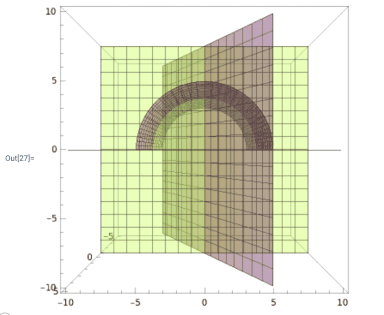

Nice diagrams, thanks, except that as noted earlier in the thread the enclosed volume includes an identical region with z<0 and x<0.
For the region shown in your diagrams, the volume was found in post #1.
Thanks for pointing out my mistake :D Do they look good now? Also the bounds for theta are [0, Pi] under polar coordinates right?
Yes, and yes.
