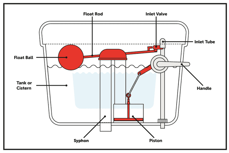

Mark44 said:
pulling up on the chain that connects to the flapper valve at the bottom of the tank
On newer toilets, the chain pulls up on a piston (which pushes water up over the top of a U-tube inside the tank) instead of on a flapper valve. That's why I was a little vague in my response about what to pull on once you opened the tank.

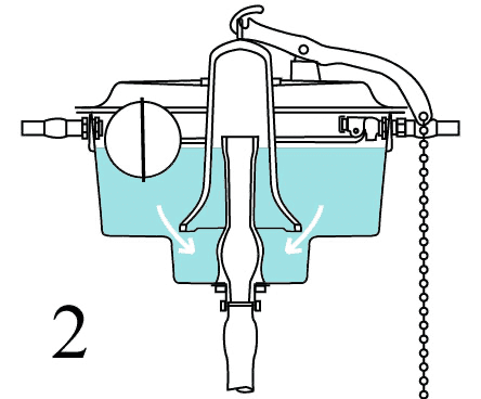

Interesting that you call them "newer toilets". In the UK, the syphon system was universal until plastic parts became common. The flap valve system is more and more common and suffers from not being fail-safe; water can leak slowly through a tired flap and waste water 24/7. The original system used an inverted cast iron bell (as in this link). The syphon itself had no moving parts apart from a lever to lift the bell and nothing to replace ever (except if the links of the chain and the pivots rusted through) but hard water can leave scale inside the bell and reduce its volume and slow down the flow. Afair, they were always situated high up to ensure reliable flushing; there was a knack to making them work. It was a fail safe mechanism (apart from the ball-cock filling system, of course). A very dramatic process; clank, clank and then the end of the world!!!
The more modern syphon systems use a piston to fill the syphon tube.
It's largely fail safe but a dodgy piston washer can crack or fray and no amount of pumping will get the syphon going. As with most plastic moving plumbing parts, they don't last well. A common problem with these is the shoddy crank arrangement and the internal link just coming adrift. Visual inspection will solve most problems.
It's possible that something like this was the case in the US before my time. The earliest US toilets I'm familiar with had flapper valves, probably because they were cheapest. The piston system has gradually become more common because it allows you to reduce the amount of water per flush and "water saving" toilets have become a thing. The fact that piston toilets also don't have the leaky flapper valve problem is an added benefit.
Another modification I've seen is to have a plastic float wrapped around the inlet tube instead of a float ball; when the float rises high enough on the tube, it closes the inlet valve. This is easier to adjust than a float ball arrangement, but it also means that if anything goes wrong with the float, you have to replace the whole inlet tube/valve/float. Fortunately I've never had one of these floats go bad.
