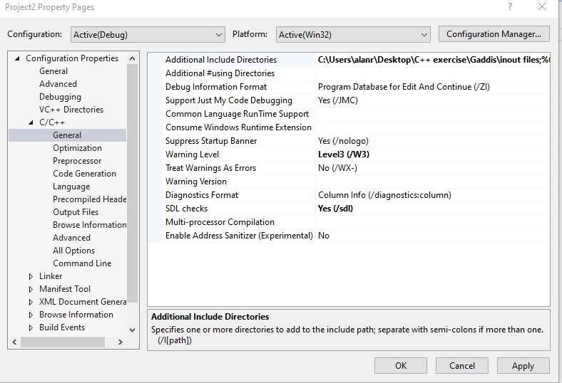

  • #64
Jarvis323 said:
Hi Jarvis
Thanks for still helping me, I really appreciate this. I follow you and get to this point but I really don't follow what am I supposed to do with it next.
Jarvis323 said:
After a search, I found that the "additional include directories" option is in the C++ General tab for VS 2019.
https://docs.microsoft.com/en-us/cpp/linux/prop-pages/general-linux?view=vs-2019
I really don't follow what's going on here. what do you want me to learn from this? I am really lost.
Thanks

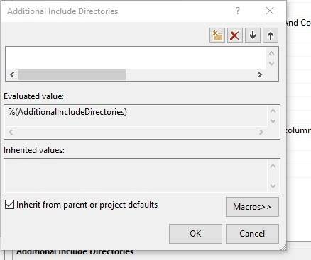

  • #65
yungman said:
Do you mean Temp.vcxproj.filter?
No, I mean just exactly what I said -- <project_name>.vcxproj. In this case, it would be Temp.vcxproj.
  • #66
Hi Guys
I really don't follow what's going on here. I thought in Solution Explorer, there is Header files that I add in the .h files and Source files that I add in the .cpp files. Maybe at this time, I should just accept that I can only do Add-->New to either the Header files and Source files in the Solution explorer, then I can move on. Any other things I need to watch out?
Thanks everyone for the time.

Thanks
You just add the path of your header files in that box that I pointed out. Then when the compiler compiles your program, it will look for header files in those directories that you've listed in the box. That is the solution to your problem. Then you won't get the error that the header file wasn't found, and no matter how you added the files to the project, it will work. I went over what is going on multiple times already in previous posts, but I guess there is a communication barrier we can't get through.
I recommend to just keep it as simple as possible and follow Mark's advice on how to get something working. If you want to figure out how to put files somewhere else besides the project directory, or figure out what was wrong with what you've done, you can always come back to and re-read the thread.

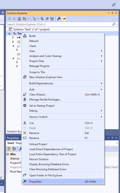

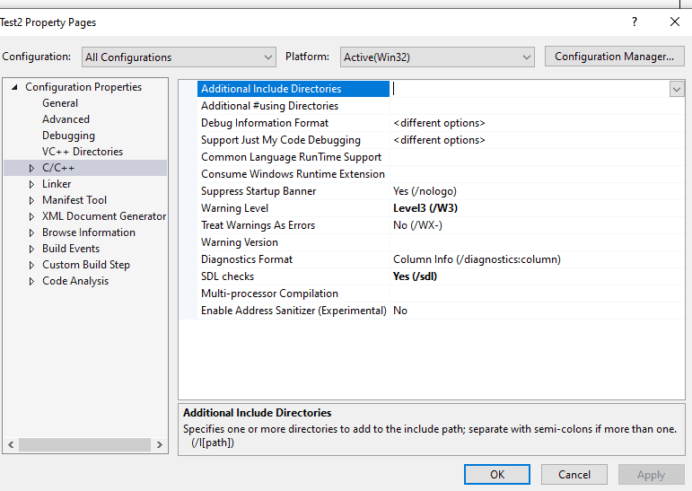

  • #71
If you have spaces in the path then you need to put quotes around it I think "c:\...". You can use the browser to select the folder if you hit the down arrow, and then the file icon.
Nothing will be indicated and no files will be added to the project. But the red squiggly under your #include "someheaderfileinrandomfolder.h" will go away and your problem that the compiler didn't know where to look for your header files will be solved and your program will compile fine.
IMPORTANT: also, the configuration selected in the upper left corner needs to be set to "All Configurations" if you want it to apply to both "Debug" and "Release" modes.
  • #72
Jarvis323 said:
If you have spaces it might be a problem. You can use the browser to select the folder if you hit the down arrow, and then the file icon.
Nothing will be indicated and no files will be added to the project. But the red squiggly under your include will go away and your program will compile fine.
I think I got it:
I click Edit, this is the menu that show up:
Then I hit the file icon and search the path and OK.
But I still don't see anything added in the Solution Explorer. Looks the same as before I added it.
Thanks
  • #73
yungman said:
I think I got it:
Thanks
It shouldn't look any different. But now your project will compile successfully. Also if you open the vcxproj file in notepad you will see a line that it generated.
