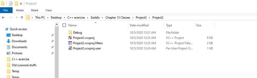

What operating system are you working on and what are you using to compile? Are you using MS Visual Studio? Whatever tools you are using, there are always ways to put the header files in one directory and keep the implementation code someplace else. That is the only way that a large group of programmers can formally agree on the interfaces before the implementation code is completed.
This is question about VS, I am running on Windows 10. I have no issue understanding what this whole thing trying to do and the code. I just don't know how to put them together.
I am trying to integrate the Specification, implementation file to work together with the program that uses it. I have no idea how to integrate them together. The book just skip this all together and act as if it's supposed to just work! I typed in the Rectangle.h file and Rectangle.cpp file. There is no instruction in running the compiler on these two files. I have no idea what to do. I already put the rectangle.h into the calling project in the same folder as the source.cpp of the project. But there is no instruction what to do with the implementation file Rectangle.cpp. I copy the Rectangle.h, Rectangle.cpp and the source.cpp here. Can anyone help me? I don't have the CD from the book.

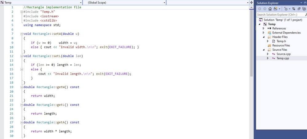

This is the Rectangle.cpp That has all the member functions.
C++:
//Rectangle implementation file
#include "C:\\Users\\alanr\\Desktop\\C++ exercise\\Gaddis\\inout files\\Rectangle.h"
#include <iostream>
#include <cstdlib>
using namespace std;
void Rectangle::setW(double w)
    if (w >= 0)    width = w;
    else { count << "Invalid width.\n\n"; exit(EXIT_FAILURE); }
void Rectangle::setL(double len)
    if (len >= 0) length = len;
    else { count << "Invalid length.\n\n"; exit(EXIT_FAILURE);
double Rectangle::getW() const
{    return width;}
double Rectangle::getL() const
{    return length;}
double Rectangle::getA() const
{    return width * length;}

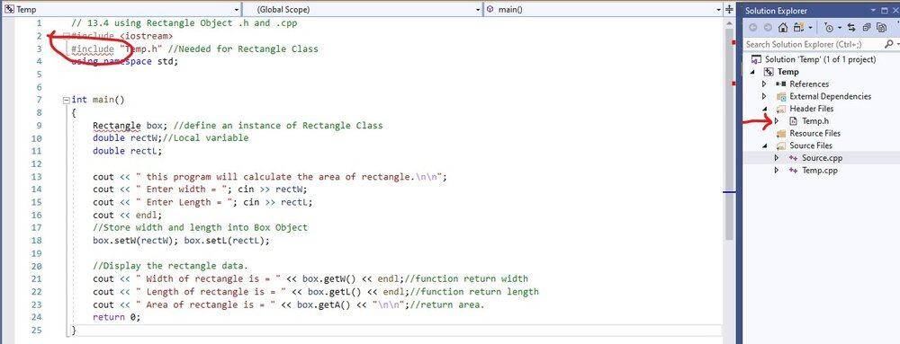

This is the source.cpp of the program that call the Rectangle class.
C++:
// 13.4 using Rectangle Object .h and .cpp
#include <iostream>
#include "Rectangle.h" //Needed for Rectangle Class
using namespace std;int main()
    Rectangle box; //define an instance of Rectangle Class
    double rectW;//Local variable
    double rectL;
    count << " this program will calculate the area of rectangle.\n\n";
    count << " Enter width = "; cin >> rectW;
    count << " Enter Length = "; cin >> rectL;
    count << endl;
    //Store width and length into Box Object
    box.setW(rectW); box.setL(rectL);
    //Display the rectangle data.
    count << " Width of rectangle is = " << box.getW() << endl;//function return width
    count << " Length of rectangle is = " << box.getL() << endl;//function return length
    count << " Area of rectangle is = " << box.getA() << "\n\n";//return area.
    return 0;

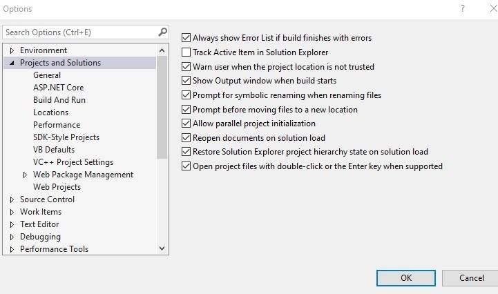

Jarvis323 said:
I guess the place you add your include directories should be here: Tools / Options / Projects and Solutions / VC++ Directories / Include files
https://stackoverflow.com/questions/2676417/how-do-include-paths-work-in-visual-studio
https://docs.microsoft.com/en-us/cpp/build/reference/vcpp-directories-property-page?view=vs-2019
Thanks for the reply
I followed your direction, it's not the same. I read the first link, it was about VS in 2008 that has the same path as yours, mine is VS2019, this is where it's different:
There is no VC++Directories.
I am still searching on the web also. I don't know how relevant is this:
http://www.math.uaa.alaska.edu/~afkjm/csce211/handouts/SeparateCompilation.pdf
Thanks
No, that's where the VS include files go. You shouldn't clutter up the VS system files with programs you're working on..

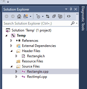

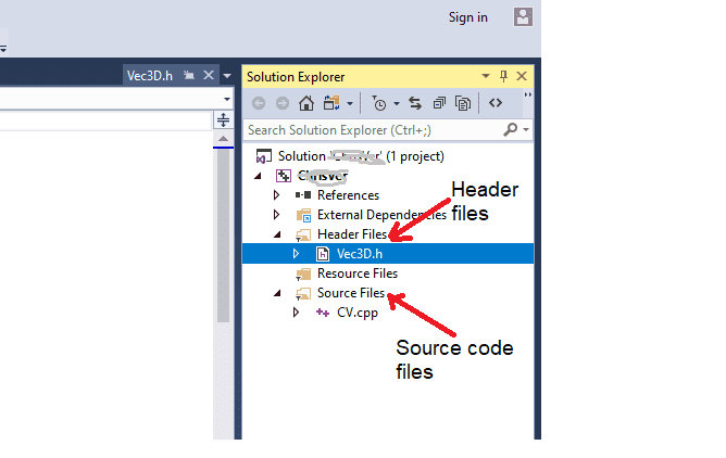

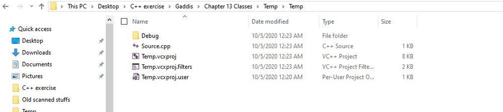

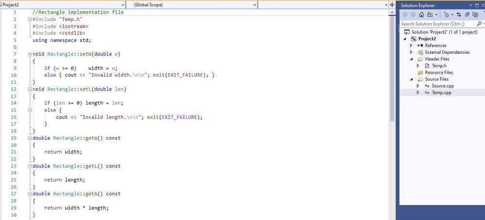

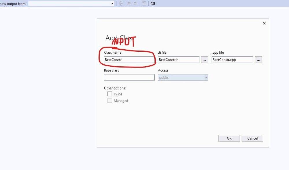

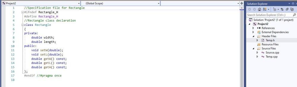

Organizing a project with multiple source files and one or more header files is pretty straightforward.
When you start a new project, the Header Files folder will be empty, and the Source Files Folder will be empty. If you want to add a header file (.h), right-cick Header Files, and Add --> New item will cause a dialog box to open. In it, select Header file, and enter a name for it, then click Add.
To add a source code file, right-click Source Files, and Add --> New item will cause the same dialog box to open. Select Header file, enter a name for the file, then click Add. There's another option to add a Class, but I don't use that option.
Once you have added the source code file(s) and header file(s), you can type your programs in, or paste the text in.
You showed Rectangle.h, Rectangle.cpp, and source.cpp for the project you're working on. Rectangle.h has the class declaration in it, Rectangle.cpp has the definitions of the member functions, and source.cpp has main().
Rectangle.h would go in the Header Files folder as shown in the screen shot above, and Rectangle.cpp and source.cpp would both go in the Source File folder. As long as there is only one main() function, you can build the project just as you have been doing.

Thanks a million! If I can, thanks TEN Millions!
You make my day! It's just THAT easy! I was so worry! Now I can go watch some tv!

I looked into it a little. There should be a place to add "additional include directories" in the project properties settings. You can probably find it by just looking around in the settings available for your VS project. When you find that, you add your directories to the list. Note this is normally used in VS for external files, that your project uses but you aren't working on within the project.
Thanks for giving me a push to look into this more. Using Project-->Add Class works.
It will open a window like this. I just typed in RectConstr in the Class name. It will fill the name for you in .h and .cpp as shown. You then click OK.
It will open a blank project with empty file RectConstr.h and RectConstr.cpp on the right side as shown below:
