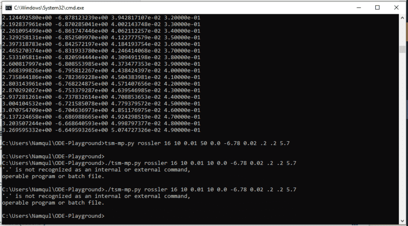

Oh btw, I've tried to execute using ./ but doesn't work. Look at this picture
ohaited said:
Oh okay then! That's the for the columns.
Ah, that is your operating system - don't worry about it then ;)

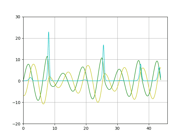

There are now some things you can do on a unixy os, but they depend on pipes. I don't know if cmd.exe can use them. You will also need matplotlib installed. Then firstly you can try:
Code:
./tsm-rossler-dbg 16 10 0.01 150001 0.0 -6.78 0.02 .2 .2 5.7 | ./plotAnimated.py 1 -20 30
without the './' I suppose. If the pipes work, you should see a progressive data plot of the x, y, z coordinates.
If this does not work, I would suggest you try this on a spare Linux box or virtual machine - there is really no excuse for not having one or the other these days IMO ;) It should also work on a mac.
Not sure how to add a picture to an existing post, but this is what you should see.
x=green, y=yellow, z=cyan.
Once this is working you can think about plotting the trajectories in animated 3D, but you need either visual python or Pi3d to display them.
