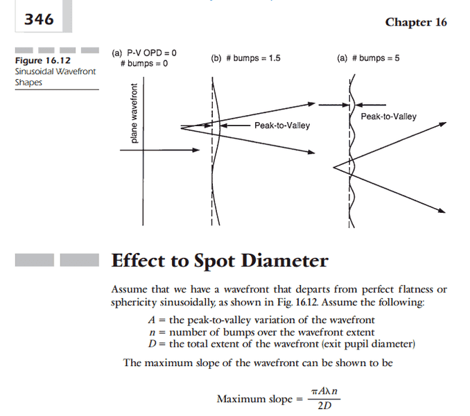

This is no homework; but I cannot work it out so I assume one of my assumption is off... no matter how much I looked at it I can't get to the textbook answer.
I tried searching (Google is my friend); I got to Prof. Burge's wonderful lectures slides (Arizona.edu) but he follows a different path so it didn't help.
The image below is taken from Optical System Design by Fischer & Tadic-Galeb. It can be found in the link below. The author describes a simple way of calculating surface slope but I cannot follow his steps and would appreciate help in deriving his simple formula for Maximum Slope from page 346:
Three diagrams of a plane wavefront passing a sinusoidal distortion, labelled (a) P-V OPD = 0 with 0 bumps, (b) 1.5 bumps, and (a) 5 bumps, with peak-to-valley marked and rays drawn reflecting from each.
http://kundoku.free.fr/O/007/Optical System Design/Optical System Design.pdf
Assuming A is in waves, I tried working out the maximum slope as the magnitude of the disturbance (A*lambda, in length units) divided by the typical length of half a bump (D/(2*n)). This gives a slope of 2*n*lambda*A/D.
My answer is 4/pi off the textbook. What might have went wrong...?

What is your definition of "the slope"? What do you understand by "the maximum slope of the wavefront"?
Following the picture you posted I reffered to the slope of the magnitude of the wavefront with respect to the spatial dimension. Then the derivative can be taken with respect to the spatial dimension (represented by vertical axis in your picture).
Thanks soarce,
Thanks for your help. You actually made me find the reason for the pi... At first I approximated the wavefront by saw-tooth, missing the (clearly noted) sine wave mention, hence no π in my initial derivation. But I still can't prove the book is right.
I think the author meant that "maximum slope" would be the max derivative of the curvy wavefront with respect to distance along the Y axis in the picture (I call it x below). If w(x) is the wavefront function, I interpret maximum slope = max(w'(x)). I scaled the PV of the sine to be A*λ.
When done with a sine wave, the π comes from the normalization to one diameter, and d(sin(u)/dx=cos(u)*du/dx.
After checking and rechecking I still end up with max(w'(x))=πAλn/D instead of the πAλn/2D .
Can't find a justification for the factor of 2. :frown:.
Thanks again for your help,
Ornit
The peak-to-valley amplitude is twice the amplitude of the sine?
True, but it doesn't help.
Let me write it down fully and properly (well, I hope not - if you find a mistake it will actually solve the problem :smile:):
w(x)=0.5*A*λ*(sin(π+2*π*x*n/D)+1)
(0.5 and +1 are for the wavefront to swing from 0 to +1 PV as you mentioned; π is just for phase shift to have the look like the 1.5 bumps illustration; sin(2*π*x*n/D) is what I think to be the critical tern for the missing factor of 2).​
Therefore w'(x)=0.5*A*λ*cos(π+2*π*x*n/D)*(2*π*n/D)
max(w'(x))=0.5*A*λ*1*2*π*n/D=A*λ*π*n/D :eek:

Looking at the picture. I interpret A as PV (peak to valley) in waves therefore multiplied the sine expression by A*λ. The 0.5 factor comes from the (sin(y)+1): this expression will vary between 0 and 2, therefore I multiplied by 0.5. Have I misunderstood your question?

Yes, people usually speak in term of fraction of lambda (aka "wave") to describe surface figure or TWD (Transmitted Wavefront Distortion). My interpretation is that this is the "A" defined in the picture. For example, if the peak-to-valley in the picture is lambda/4, A=1/4 and my scaling is A*lambda.
