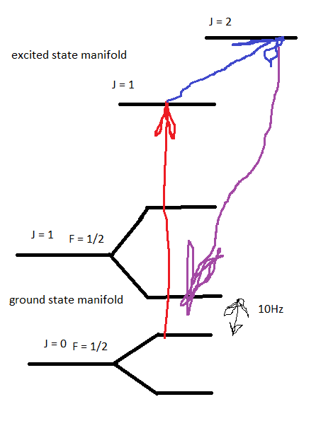

I attached a little cartoon of what I had in mind for the 2 laser + 1 microwave STIRAP. @kelly0303, is the ground state structure I drew approximately what you have in mind? (I chose J = 0,1 and F = 1/2 for simplicity.)

The field stability problem is brutal. Good catch ES137. @kelly0303, remember that the bohr magneton is about 1.4 MHz/G. That's 14 GHz/T. That means to get a stable 10Hz splitting with a 1T applied field, you need to stabilize the B field to on the order of 1 part per billion (ppb), or fluctuations under ##10 \mu G##. I haven't thought about this stuff in a while, but it sounds very difficult based on past experience.
Also good catch on Paschen-Bach regime. My cartoon should not contain F but instead ##\Omega## (assuming Hund's case (a)).
One possible trick to solve the field stability issue is co-magnetometry. Would need a lot more info to tell you if its feasible in your molecule. The ACME eEDM experiment has a comagnetometry state (i can't remember which state it was), so that might be a good place to look for inspiration.

I probably should've labeled those... but why spoil the mystery!
Red & purple: lasers connecting the ground states to different rotational levels in the excited state manifold, with polarization chosen to allow only one or the other of the two 10Hz split states
Blue: microwave connecting the excited state rotational levels

@kelly0303 Yes, I was thinking a 3-pulse STIRAP sequence composed of two lasers and one microwave source, or 3 microwave sources. It's very possible that this is overkill. To do this, since as you say the laser linewidths will be greater than 10Hz, you will need to make for each laser pulse, you choose the polarization so one of the two parity states is forbidden. Since these are molecules, where transition rules are more like guidelines, you may want two degrees of forbidden-ness. If you use microwave sources, then as @f95toli says, you will have <<10Hz linewidths so you can be energetically forbidden. For STIRAP, if I remember correctly the trick is that all your driving fields need to have stable relative phases, and you need a fair bit of power.

On to the physics, as far as my STIRAP suggestion, I would just add that what I had in mind was using STIRAP to generate a pi/2 pulse, that could then be used in a Ramsey sequence to measure the interaction strength. I wasn't suggesting direct Rabi spectroscopy, because the interrogation time would be very short.
