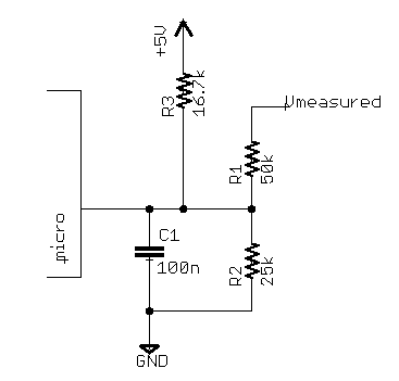

To measure the PV string voltage will require a couple of high-voltage resistive attenuators, followed by a difference amplifier. That is dangerous ground.
Measuring PV voltage will not be as much use as measuring the current, but current only flows in the PV string when there is some load.

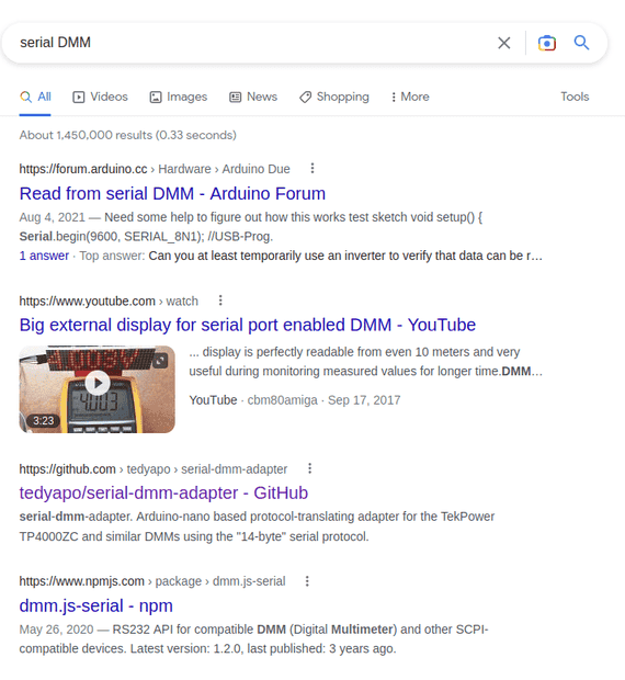

... the only safe solution I can suggest is to get a DMM with remote (bluetooth?) connection.
If it's a handheld one then please DO NOT try to hack with the battery.

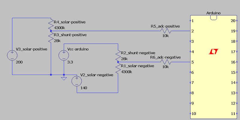

There seems to be a phase-pattern to the solar-ground balancing. Starting at night, there is <5V from the solar. When voltage increase, the negative seems to stay near GND (within 5-10V) until the solar positive reaches battery voltage (near 48V). As the solar voltage continue to increase the positive stays at battery voltage while the negative drops until it's about 140V below GND. As solar voltage increases even more, the negative stays there (relative to GND) while the positive increases.
Wonder if this can be done very simple. I needed to see nsaspooks circuit to get the idea. The idea is simply to put a voltage divider (R3, R4) with high resistor values between solar positive and GND to measure/calculate the positive solar voltage. Then put an other voltage divider (R1, R2) between solar negative and aurduino power supply (48V->3.3V buck converter) positive to measure/calculate solar negative voltage. By adding those measurements I should be able to get what I want.
What is the downside of using high resistor values? Could they be too high? The highest I have is 4.3M. Using 28k shunt resistors (R2, R3) I hope this circuit will serve the purpose even if solar goes 500V above or below GND (even handels both at the same time). (I plan to log max/min voltages over time, and based on that I can safely increase the shunt resistor values if better accuracy is needed.)
In the circuit attached V2 and V3 combined serves as the solar input, they are split in two in order to balance them around GND.
Are the R5 and R6 serving any purpose? I'm thinking they might protect the Arduino, but I'm not sure.
(I think my arduino pro micros are 3.3V. Have to figure out how to confirm that.)
Does this look like it would work?
Resistors have a voltage rating that is often ignored.
Assume there is a limit of 100 V per resistor. That will also reduce surface leakage currents, and stress on the PCB. For example, a 400 V divider will require four equal resistors in a series chain.
Once resistor values go above 100k, you need to protect them from condensation and the environment.

Identify the manufacturer through the supplier, and get their data. Otherwise, assume 100 V.
Why is condensation an issue with high value resistors?
Because leakage current, across the dirty wet surface, is in parallel with the resistive element.
After hand assembly, your fingerprints can be a problem.
Resistors run warm, which attracts life in a cold environment.
Moulds grow on surfaces, insects excrete, and mice pee.
Operate the equipment in a clean and dry environment.

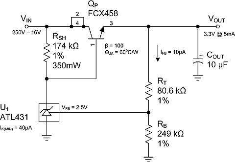

So, using this... what's the best way to supply power to the high side of this thing? Voltage is to high for any buck converters I've seen. Could a voltage divider (1:6) work to supply power to a buck converter that supports up to 90V input? (I have a couple of those laying around)
Maybe something like this would work (needs modifications to accept more than 250V in, and 5V out)
Source: https://www.planetanalog.com/build-a-high-voltage-linear-regulator/

I do lean towards the circuit posted in #18. (Replacing large resistors with chain of smaller ones.) It's ugly, but if the resistors are large enough it shouldn't cause problems. (I can leave my voltmeter there without making trouble.) It's advantage is that it does not require any power supply on the solar side.
