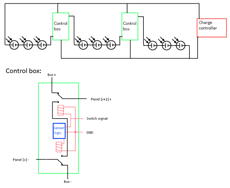

The attached drawing shows how I'm thinking 9 panels can be converted from 3 parallel strings of 3 (relaxed state, no signal), to a single string of 9 panels. The upper drawing shows how panels and control box are connected, while the lower drawing shows the inside of the control box. Drawing shows the relays in relaxed state (no input signal). When the switch signal input receives power, the upper relay will disconnect a panel string + from the "Bus+" (Charge controller +) and connect to the lower relay. The lower relay will disconnect a panel string from "Bus-" and connect to the upper relay. The sum of the two relays is that the negative of panel x will be connected to the positive of panel x+1. When signal power goes out, the relays will flip back to relaxed state.
The risk here is that if both relays in one control box goes from relaxed to engaged state before any of the relays in the other control box, there will be a condition where a string of 6 panels is parallel connected to a string of 3 panels. I imagine this will damage the 3. And the same risk will apply when signal power goes out.
So far all my ideas for relay feedback circuits has been a failure.

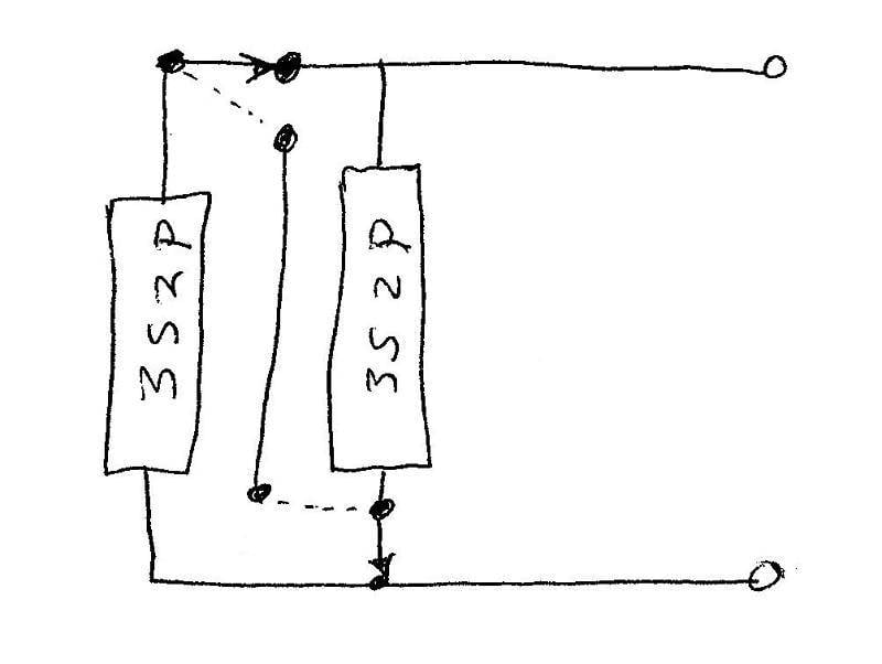

I see two ways of doing the switching, both require the PV array be reduced to 3 modules, making 6 wires from the PV array to a control box.
1. The series/parallel switching could be done with five poles of two position switch. There would be flyback diodes to protect the switch contacts. You would need to flip the switch or switches by hand to change between series and parallel modes.

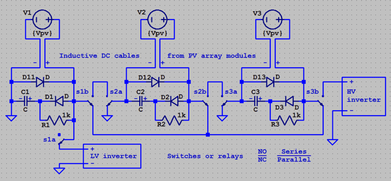

2. An automatic system would not use relays, but would employ MOSFETs and diodes, to do the switching. It would be more of a challenge to implement that solution in the field because it requires custom designed electronics and so has safety and legal implications.
When switching DC current sources, to prevent high-voltage inductive voltage spikes appearing during the changing configuration, the elements of the array can be individually short-circuited, (by say an isolated MOSFET). That is a little understood technique and must be applied with care.
Zero volts times full current represents zero power lost in the switch or the current source. The short circuit must not be removed until there is a load or a snubber to conduct the current.

Can you wire your 12 panels into two modules, with each module wired 3S2P (two parallel strings of three panels in series)? Then connecting the two modules in parallel would result in 3S4P for the total system, while wiring them in series would result in 6S2P for the total system. One DPDT switch that is rated for the total voltage and current can switch between the configurations. That switch must be break before make, and ideally would have a center OFF position. Such switches are used as manual transfer switches for backup generators.
You might want a second such switch to transfer between the two controllers. If you never, ever forget to disconnect the controller before switching the panels, then there would be no current through the panel switch during switching so no switching transients.

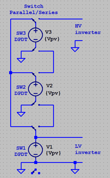

Three equal sub-strings of PV array are connected by three DPDT switches. Each sub-string Vpv is controlled by one DPDT switch. All switches should be set to select the same mode.
Turn off the HV inverter before switching.
This arrangement prevents HV being applied to the LV inverter. The low-power LV inverter is always connected, unless the spare switch contacts are used to isolate it.
I think the short circuit during switching is not needed because there will be 0 current for quite a while after switching. The switching process will be:

The risk will off course be that if, for some reason the switch signal is lost while charging is in progress. If the system is designed so that 0 signal means that the circuit reminds in its current state, that is not a problem. Is the circuit is designed so that it jumps to parallel mode (cloudy day mode) when signal is lost, the problem should be minimal as the main charger would switch off when that happens (it has a build in relay (at least some part that says 'click') that is triggered by high voltage on the solar input). An unintended switch from serial to parallel will make the voltage drop enough for this relay to disconnect. All though it does take some time for this to react.
An unintended switch from parallel to serial connection will for sure be dramatic.
My biggest concern with the relay approach is that one relay reminds (either slow responding or stuck) in "parallel mode" while the others switch to "serial mode". And as this may experience temperatures from -30C to +50C, mechanical parts, like a relay, are more likely to fail.
This arrangement prevents HV being applied to the LV inverter. The low-power LV inverter is always connected, un<less the spare switch contacts are used to isolate it.
Actually, that way of connecting would be quite fail safe. The HV charger has a relay build in that is triggered by solar input voltage. Once voltage is in the LV range, it will disconnect. And when switching from LV to HV, the relay has a delay for connecting.
But the LV charger has no such relay. And thats where the high currents go. I theory the LV solar current can reach (spike) to 54A, before the limiter kicks in. If sw1 is the last to be switched from HV to LV it will have quite a current to deal with.
Currently I use 2 pole DC auto fuse breakers to (dis)connect the chargers.

Baluncore said:
I like this a lot because of it's quite failsafe without any sensors. A simple modification is to replace the DPDT switches with some DPDT relay or mosfet or SSR. How could this failsafeness be kept when putting two of them in parallel? Even if there is such a thing as a 4 pole relay, it will be unpractical to have all poles in the same spot. I'll need them distributed over a 10-15m stretch. (Or run long cables.) My panels are in 2 areas, 10m cable between them.

I have now taken a look at what might happen with long inductive cables to the switch box.
When any PV module is disconnected while current is flowing, there will be an inductive voltage spike that will arc over and burn the switch contacts. With DC the arc may continue and not be extinguished by voltage reversal as is normal with AC. To prevent that arc, a snubber circuit is required, as shown in the diagram. The snubbers use no power in normal operation.
Each component of the snubber has a specific purpose.
When module x is switched out, the positive spike charges Cx through Dx, limiting dv/dt.
When another module is switched out, the reverse voltage spike is caught by D1x.
After any switch event, Rx = 1k, restores the idle voltage across the capacitor Cx.
Diodes should be fast, and rated at least for momentary current of the PV array current. Heat sinks will not be required by chunky diodes, as the switch event is fast and rare.
Capacitor selection for say a 20 amp module current, 50 volt over voltage, and 10 us duration, will require;
C = 20 amp * 10 usec / 50 volts = 4 uF minimum.
The capacitor voltage rating will need to be at least 50 volts above the maximum PV array voltage.
I would consider scrounging the high voltage electrolytic capacitors and diodes out of old switching computer power supplies.
