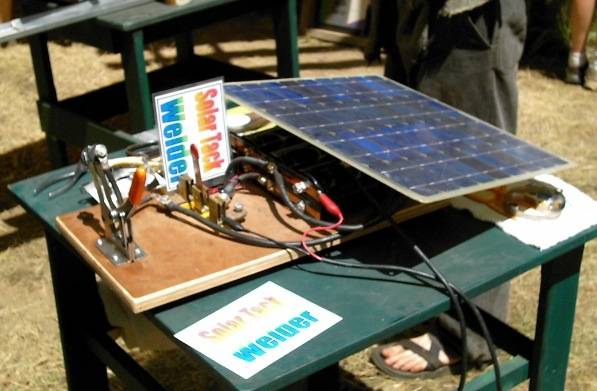

Anyways, on a somewhat related side note. I saw a solar powered tack welder this year at the local fair.
There was no intermediate circuitry.
Two super-caps, one solar panel, one knife switch, and some sheet metal scraps.
It was beautiful.
