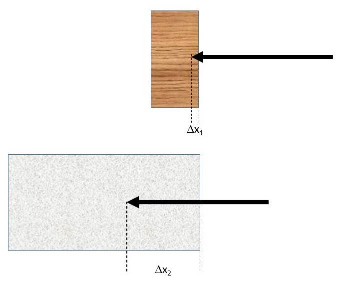

So now that we have this down, let's look at your arrow. The question can only be answered if you can make an estimate on (i) how fast the arrow is moving right before it hits the object, and (ii) how far it went into the object. Let me explain by using this picture below:
Let's say in the top part is the arrow being shot into a piece of wood, while the bottom part the arrow is shot into a piece of jello.
It will travel very little when it enters the wood, and so, it travels a short distance Δx1. On the other hand, it travels a longer distance Δx2 before it is stopped. If it enters with the same speed, and it travels until it is stopped, then it travels for a LONGER period of time Δt when it enters the jello, i.e. Δt1<Δt2
If you apply this to the force equation that I wrote at the beginning of this, it means that the force that is applied by the arrow is larger when it hits the wood than when it enters the jello.
What I'm trying to illustrate here is that there is no one single value. The impact force here depends on how much the arrow moves while it is being stopped by the material.
