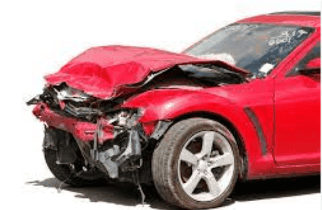

In my opinion, visualizing a car crumpling as in the photo can help the OP to understand.
  • Crumpling does not happen in zero time.
  • When velocity reaches zero (but not before), crumpling stops.
  • A slow moving car has less crumpling and less force, maybe just a dent.
