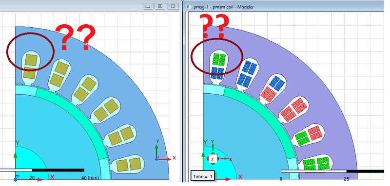

I use Ansys software for finite element simulations. Maxwell, Simplorer, RMXpert and other toolboxes. but I always have a doubt on how to model a coil?! should we use a single geometry as a whole coil or we should draw wires one by one! but even if we could, what should we do about twisted litz wires? it is almost impossible to model them in real shape.
what consideration should have in modeling?

I have simulated a sample of single geometry coil using stranded coil or model all conductors. The sample is a BLDC motor and of course with low frequency. the results was very close. so in low frequency excitation the difference is negligible. You can find the simulation conditions here:
