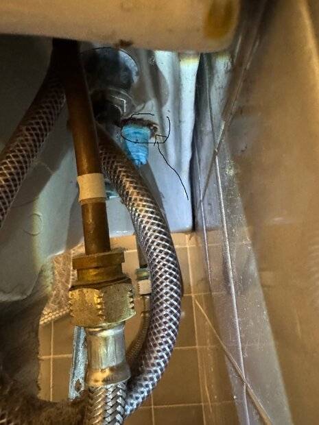

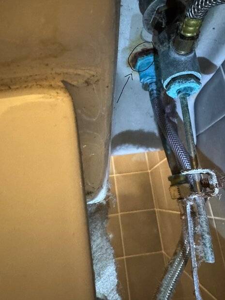

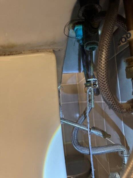

Bathroom faucet replacement
Hi guys, does anyone know what is the best way to unscrew, release the piece shown in the images? I need to replace the bathroom faucet and underneath is heavily rusted...an old design...there is no space for a wrench or anything I can think of... could anyone suggest how this is done?
without having to disassemble the entire porcelain sink...thank you a lot for any suggestion.

Not sure about the pros, but I use a 'basin wrench':
Consider sliding a long "tube spanner" up the hose to undo the top nut.
Tube spanner; AKA; Shower Valve Socket, Wrench box spanner, spark plug spanner, etc
https://www.ebay.com.au/sch/i.html?...cat=631&_from=R40&_trksid=p4432023.m570.l2632
Tube spanners can often be joined end-to-end, to gain length.
Alternatively, drill holes in the big nut from below, using a drill extension, so it can be opened, and broken apart.
This is the normal tool. I had one that didn't open quite far enough, so maybe check your dimensions first.
If you're lucky, skinny and have long arms, and it's not corroded, you might, maybe, make do with channel lock pliers.
You might get better answers from google than us.
This is another tool option which I've seen in various formats. I suspect there are others too.
https://www.homedepot.com/p/Husky-2-in-Universal-Faucet-Nut-Wrench-410-073-0111/311493703
