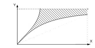

Jbreezy
582
Set up the integral (but do not solve) for the volume of the object created by rotating the region bounded by y = arctan(x) and y = arcsin(x) in the first quadrant.
I = ∏∫(f(x)^2 - g(x)^2) dx
a.) rotate about he x axis
I came up with
I = ∏∫(arcsin(x))^2 - (arctan(x))^2 dx between [0,1]
b.) rotate about the y -axis
I came up with
I = ∏∫(arctan(x))^2 - (arcsin(x))^2 dx between [0,∏/2]
Did I do this correctly.
Thank you.

That's why I said, you have to change the functions into functions of ##y## and use a different method entirely. You won't be able to solve this with the usual method you've been using. The functions as is in the problem only have ONE intersection and therefore do not bound any particular area.

I don't care if it is "straight to the teeth", written in gold ink, and blessed by the Pope. Those two curves do not enclose a region in the first quadrant. A reasonable GUESS might be to add the line ##y = \frac \pi 2## to the area description. That would define a region that is infinite in extent requiring improper integrals. You have to properly define your region before you try setting up any integrals.

Here is a picture of the presumed region, assuming the upper boundary is ##y = \frac \pi 2##. The actual region continues on infinitely far to the right as the arctan nears its asymptote.
Thanks, I see what you are saying but how am I supposed to do this problem then? Revolving it around the x-axis and using the disk method? Maybe I could do it with respect to x and go from 0 to 1 then go from 1 to infinity? I mean this makes no sense as a question considering the chapter of information I'm supposed to use.
Yes, if you want to use the disk method for revolving about the x axis, you would need two integrals just as you say from 0 to 1 and from 1 to infinity, because the upper radius changes.
You can do the disk method around the y-axis with one integral. Show us what you get for each.

This is what I set up though.For about x I have
I_1 = ∏∫(arcsin(x))^2 - (arctan(x))^2 dx from 0 to 1.
I_2 = ∏∫((∏/2)^2 - (arctan(x))^2 dx and from 1 to infinity
Volume is then I_1 + I_2 = A
About y
I = ∏∫(tan(x))^2 - (sin(x))^2 dy from 0 to ∏/2.

No, close but still not right. It should be of the form ##\int x_{right}^2 - x_{left}^2~dy## where the ##x## values are given ##x## in terms of ##y## from the curves.
About y
I = ∏∫(tan(y))^2 - (sin(y))^2 dy from 0 to ∏/2.
? Opps
good?
Jbreezy said:
About y
That's correct now.
