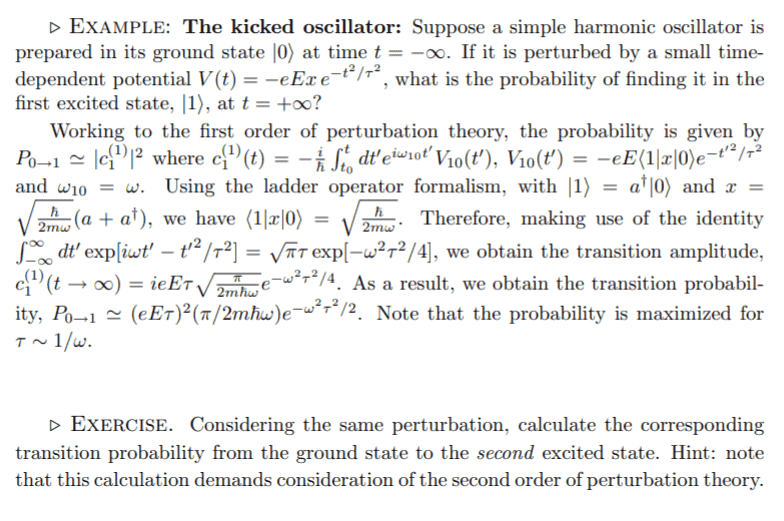

By the way, here is a sample problem in an anonymous textbook that gave me the indication that this problem could be addressed in some standard way by undergraduates. See the "Exercise" at the bottom.
The solutions we've come to so far seem beyond what is being suggested in this example problem. Any thoughts?
