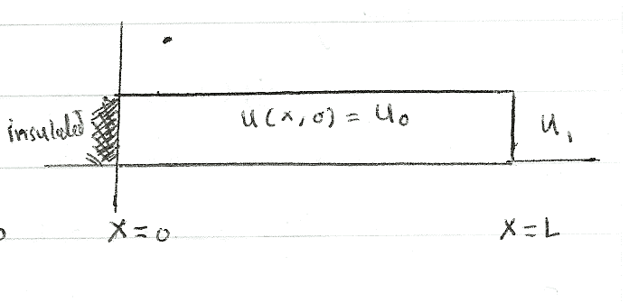

solve the following heat problem using FFCT:
A metal bar of length L, is at constant temperature of ## U_0 ## , at ##t=0## the end ##x=L## is suddenly given the constant temperature of ##U_1## and the end x=0 is insulated. Assuming that the surface of the bar is insulated, find the temperature at any point x of the bar at any time ##t>0## , assume ##k=1##
heat eq.
## \frac {\partial^2 u} {\partial x^2} = \frac 1 k \frac {\partial u} {\partial t} ##
with the following additional equations:

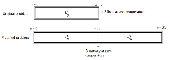

For example, in the set ##\cos \left(\frac{(2n-1) \pi x}{2L} \right)##, you have ##\cos \left(\frac{3 \pi x}{2L} \right)## when ##n = 2##. But this function is not contained in the set ##\cos \left(\frac{n \pi x}{L} \right)## for any value of the integer ##n##.
I think there might be a "trick" way to solve the problem using the FFCT. Consider a related problem where you have a rod of length 2L which is insulated at both ends as well as the sides. Suppose the initial temperature distribution is ##U(x, 0) = U_0## for ##0 < x < L## and ##U(x, 0) = -U_0## for ##L < x <2L##. Also, suppose that ##U(L, 0) = 0##. You can solve this using the FFCT since the boundary condition at both ends is ##U_x = 0##. I think the solution for this problem relates in a simple way to the solution for the original problem.
Here, the "original problem" is your problem with the right end set at 0 rather than ##U_1## for convenience. But, that's easily taken care of.
I have not actually carried out the calculation, but I think it should work.
