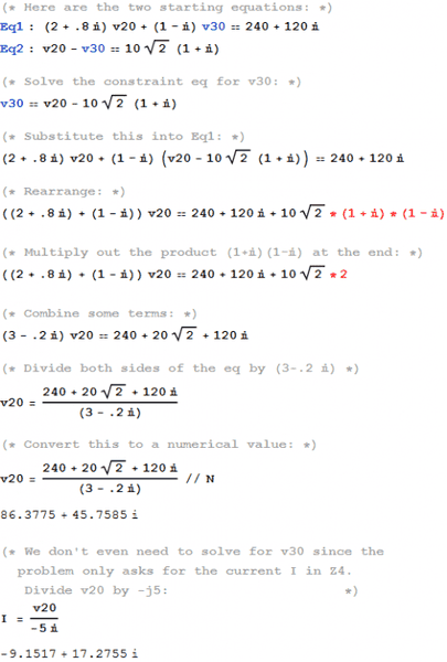

David J said:
Good Morning
I don't fully understand the meaning of the constraint equation, however, after doing a lot of research I think its something that is fixed, something we know for definite. So in this case I need to find that equation for this problem.
There is a voltage source, v3, connected between v20 and v30. Its presence forces a relationship between v20 and v30. That relationship is given by the equation v20 - v30 = v3
David J said:
I still have ## ( 2 + 0.8j)v20 + (1 + j)v30 = 240+j120## You have a sign error here. You should have:
## ( 2 + 0.8j)v20 + (1 - j)v30 = 240+j120## You realized later that there was a problem with this equation.
If I change this around to find v30 I get ## (240+120j) - (2+0.8j) v20 = (1+j) v30##
## (240+120j) - (2+0.8j) v20 = 238 - 120j## What happened to the part in red? You can't just ignore it.
If I then ## \frac {238-120j} {1 + j} = 59 - 179j##
This could mean ## v30 = 59 - 179j##
What you must do is to solve the constraint equation for v30 and substitute that result into your first equation (with the sign error fixed). Then you get an equation you can solve for v20.

David J said:
Hello again
I tried again but still I cannot get the correct answer. I will show you the calculations I have made.
Starting with the change of the sign in ##(2+.8j)v20+(1-j)v30=240+120j##
so ##(240+120j)-(2+.8j)v20=(1-j)v30##
so ##(240+120j)-(2+.8j)v20=238+119.2j)## What happened to v20?
so ## \frac {238+119.2j}{1-j}=59.4+178.6j##
so ##v30 = 59.4+178.6j##
Have i solved the constraint equation for V30, answer being ##59.4+178.6## ?
Show the constraint equation here:
Now bring v30 to the left side and everything else to the right side:
I would like to think this is correct but I am not so sure as it does not fit into the rest of the equation.
This makes me think something is wrong further back in the working out, possibly the first equation.

You didn't follow the advice I gave you in post #8.
Here's what you would get if you do so. I used Mathematica to produce this image and a special symbol is used for j; that should be easy to follow:
I thought i had followed this advice but when I check back I have not followed it correctly, due to not fully understanding. I did touch briefly on this subject in post 5

I notice you have described ##v30## as ##10\sqrt2(1+j)##
I am trying to recap on this now, going back through each step from the beginning to see where I went wrong or where I mis understood, using that attachment you sent as a guide.
In my first equation i had ##(2+.8j)v20 +(1+j)v30## ##(1+j)## was wrong. It should have been ##(1-j)## Can I ask how ?? because I am trying to understand this and I can't see it.
You eventually solved the constraint equation correctly in post #12, but you didn't substitute the results of that into the first equation. You substituted something else that you derived from manipulations of the first equation itself.
"I notice you have described v30 as10√2(1+j)"
It's V3 described that way.

You made a sign error when you went from the equation above to the final one: (2+0.8j)v20+(1-j)v30=240+j120
Go through the steps very carefully.
I see it now.
