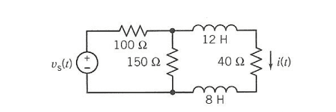

I am given that vs(t)=25u(t)-10 and the following circuit
Circuit schematic with voltage source vs(t) on the left feeding a 100 Ω resistor in series, then a 150 Ω resistor in a vertical branch; to the right, a 12 H inductor in series with a 40 Ω resistor and a 8 H inductor on the lower branch, with current i(t) labeled downward.
I would set the 12H and 8H as short circuits and then try to use KVL to find the current, but this doesn't work. I know that the answer is: 90-150e^-5t mA

Before doing anything I'd suggest simplifying the circuit first, making a Thevenin equivalent out of the resistor network. That would leave you with a single loop containing a (scaled) source function, one resistor, and one inductor.
Then consider the implications of the source function having a non-zero component that predates time t = 0. Hint: it might be helpful to find the steady state conditions for t < 0 and t >>0. How will the transition between those states look (what form will it take graphically)?
