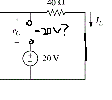

Find the desired currents and voltages for the circuit below.
These are my attempts at doing this question, and I was wondering if I am correct so far.
At t= 0-, i(L) will be 0A, since the capacitor acts as a open circuit.
However, I'm not sure why V(c) at t=0- will be -20V as given by the answers. Won't it be 0V?
Moving on, since current in inductor and voltage in capacitor does not change immediately, the values for t=0+ will be the same as t=0-. (Again, I'm not sure why it is -20V for the capacitor, could someone explain to me?)
The voltage source was connected in the circuit for a sufficiently long time. So the circuit was in steady state before the current source was switched at t=0.
You are right about the inductor current and capacitor voltage at t=0+.
Based on this conclusion, what can you say about VR at t=0+?

jisbon said:
Regarding the voltage, what I do know (from theory is that)it will be a open circuit, but I'm still unclear why it is -20V in this case.
What is the potential difference across the capacitor at t=0-? You know there is no current through the capacitor. There is no current source in the circuit yet.
Apply KVL and compare it with the reference polarity.
Also, why have you replaced the inductor with a short circuit in your previous post?

jisbon said:
Hence voltage of resistor at t=0+ = 80V?
No.
Hint: Voltage across the resistor is the sum of capacitor voltage and 20V source voltage.
You already know the capacitor voltage at t=0- and t=0+.
What does that tell you about the voltage across the resistor at t=0+?
Keep in mind the initial conditions of L and C that you already stated correctly. You need to use them to verify if your assumptions are correct.

Ah okay, since voltage across the resistor is the sum of capacitor voltage and 20V source voltage, and voltage at t=0+ of capacitor =-20V, -20+20=0V
