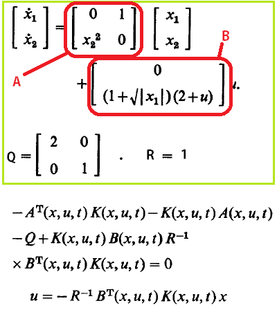

abdooo89
How to find matix K (Riccati equatin) <<<<<< pleas help me
i need help please
abdooo89 said:
i need help please
Can you post more of the original assignment? It's not very clear what the meanings of the various terms in your post are.
i need only matrix K for a given matrices
the riccati equation is
A'K-KA-Q+KBR-1 B'K=0
the problem in this system is non-linearity that is why the riccati equation is hard to solve
