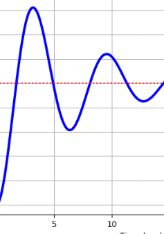

For a simple single-valued curve, nearly linear it doesn't make much different. But there is no law that forbids a V-I curve that is many valued and almost any nonlinear shape. In a case like that, a line from the present V, I back to the origin is pretty useless. Differential R might be useful. But we could also solve a circuit containing such a device without ever defining any R, we just have V=f(I) or I=f(V).
Here's a silly example. No real-life device I know looks like that, but I'm just illustrating the generality of V versus I relationships.
I guess this makes sense, my definition of resistance is perhaps slightly arbitrary.
