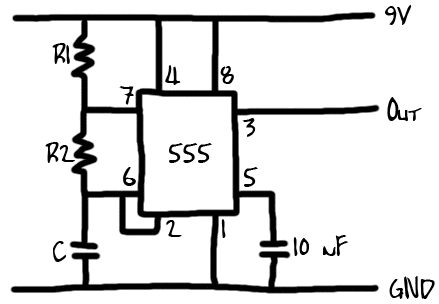

Hi Bud,
Use the 555 timer circuit attached and this website for resistor and capacitor values kpsec.freeuk.com/555timer.htm

Wow that was of great help as there is lot of such stuff present on the website that made me aware of many things that I didn't know about 555.
I want to ask one thing here. . . On the website its written : "A low frequency astable (< 10Hz) can be used to flash an LED on and off, higher frequency flashes are too fast to be seen clearly. Driving a loudspeaker or piezo transducer with a low frequency of less than 20Hz will produce a series of 'clicks' (one for each low/high transition) and this can be used to make a simple metronome. "
So does it mean that I must choose my C1=10uF ?(as my purpose is to blink the LED for 1 sec ON and 1 sec OFF)
I would probably choose C1=2.2μF (or use a pair of 1μF caps in parallel).
Note that electrolytic capacitors have wide manufacturing tolerances, perhaps as much as +100% and -50% so you should expect to have to adjust R or C to obtain precisely 0.5Hz if that's what you are aiming for.

Okay :) Thankyou very much for your guidance:) I'll definitely come here with my results and let you all know how things turned out for me :)
