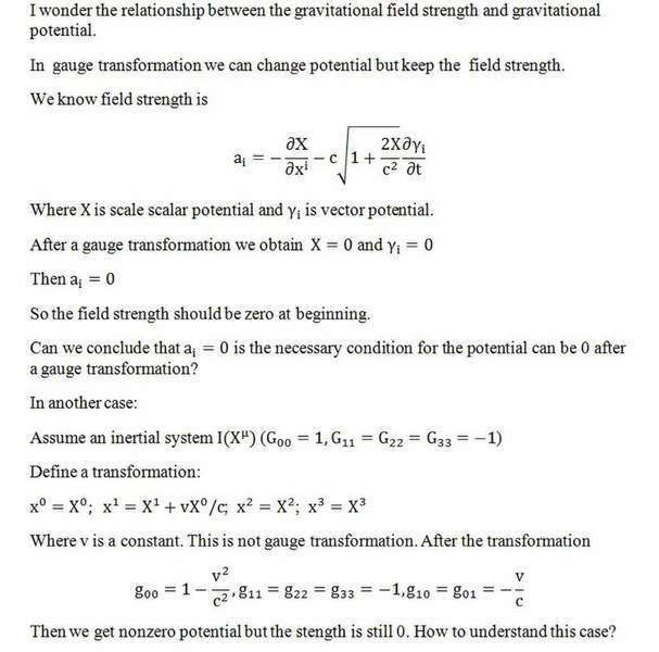

Where are you getting these definitions for potential and "field strength"? They look like electromagnetism to me, not gravity.
"Gravitational potential" is not even defined in general; it's only defined in stationary spacetimes, and in those cases it's a scalar, there is no "vector potential". The gradient of the scalar potential, in cases where it's defined, is the "acceleration due to gravity", but this is not usually referred to as the "gravitational field strength".

nenyan
- 67
- 0
Yes. That is what I said.
compare to electromagnetic field: E=dF/dQ
we can define gravitational field strength: a=dF/dm
dm is the mass of test mass point (herer dx^i/dt=0)
Then we can define the potential and find a specific transformation to vanish the potential but keep the strength (a).
If the potential is 0 then the strength will be 0. How to keep the strength? I misunderstood sth?

nenyan said:compare to electromagnetic field: E=dF/dQ
But there's a key difference: dF/dQ can vary for different objects. dF/dm is the same for all objects, because of the equivalence of inertial and gravitational mass: all objects "fall" with the same acceleration in a gravitational field. So dF/dm can't be a field strength in the sense that dF/dQ is for electromagnetism. That's why you're running into problems.

Could you please explain it in detail? Why I run into problems?
What is field strength? In my opinion, it is a parameter to describe a property of the field. The property is belong to the field, it is the nature feature of the field.
dF/dQ is determined by the EM filed itself and has nothing to do with the electric quantity of test charge.
dF/dm_g is determined by the G field itself and has nothing to do with the gravitational quantity of test mass point (m_g). From the equivalence of inertial and gravitational mass, we obtain dF/dm=a. So we use "a" to describe the strength of G field. "a" is determined by G field itself.

nenyan said:Could you please explain it in detail? Why I run into problems?
Because you're looking at something that is not invariant but thinking of it as though it *were* invariant (see below).
Also, you're ignoring key differences between electromagnetism and gravity. As I said in my last post, all objects fall with the same acceleration in a gravitational field; but all objects do not "fall" with the same acceleration in an electromagnetic field. Furthermore, when objects are acted on by an electromagnetic field, they feel a force; but when objects are acted on by a gravitational field, they do not feel a force: they are in free fall. So your "a" does not work the same as the "field strength" in electromagnetism; yet you are trying to treat it the same. That doesn't work.
nenyan said:What is field strength? In my opinion, it is a parameter to describe a property of the field. The property is belong to the field, it is the nature feature of the field.
This doesn't really say very much; lots of different things can meet this description. For example, the potential itself has the same property. What picks out "field strength" from among all the different things that can be properties of the field?
nenyan said:From the equivalence of inertial and gravitational mass, we obtain dF/dm=a. So we use "a" to describe the strength of G field. "a" is determined by G field itself.
But "a" is also frame-dependent; that's what you showed in your OP. You can always find a frame that makes "a" zero at a chosen event. So "a" cannot be an intrinsic property of the field itself; your choice of frame also affects it. (And since changing frames corresponds to a "gauge transformation" in GR, your "a" is not gauge invariant either, so it can't be a "field strength" in the sense that E and B are in electromagnetism, since E and B *are* gauge invariant.)
If you want to find something that is purely a property of the field, you need to look at invariants: things that don't change when you change frames. For example, ##h_{\mu \nu} h^{\mu \nu}##.
(Note, by the way, that the EM counterpart, dF/dQ, is also frame-dependent; you may not be able to find a frame that makes it zero at a given event, but you can certainly *change* it by changing frames. So your EM definition of "field strength" isn't really correct either; you should be looking at the EM field tensor ##F_{\mu \nu}##, or more precisely the invariants associated with it, such as ##F_{\mu \nu} F^{\mu \nu}##.)

Thank you Peter. I kind of understand...
