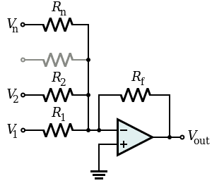

A calculator/computer doesn't necessarily mean assembling a bunch of logic chips. You could make a simple Electronic Analog Computer which uses electrical components, such as capacitors, inductors, resistors, and operational amplifiers to model physical systems of linear mechanical components.
For example, here's how you would add several inputs (in volts) to get the negative output sum (in volts).
By using an Op-amp and some resistors (d.c. power supply required). Here are other Operational amplifier applications.

dlgoff said:
For example, here's how you would add several inputs (in volts) to get the output sum (in volts).
(Actually, the output voltage of this circuit is the negative sum of the inputs...) :smile:
Well, yes. :redface:
minus 2 points, sign error. :-p
