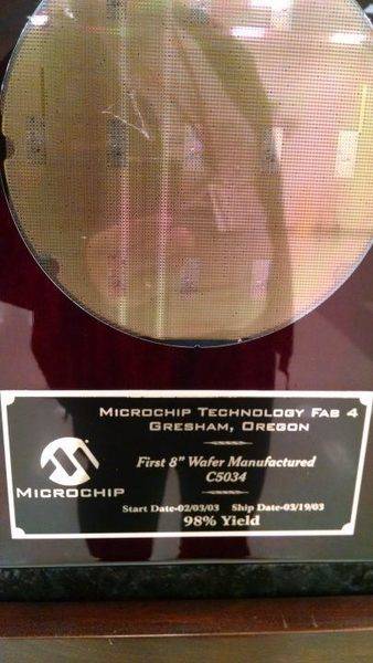

After all that work the first good ones are framed.:-p
Framed trophy plaque with a polished silicon wafer mounted above a brass plate reading MICROCHIP TECHNOLOGY FAB 4, GRESHAM, OREGON, First 8" Wafer Manufactured, C5034, Start Date 02/03/03, Ship Date 03/19/03, 98% Yield.
98% yield -- nice! :smile:
