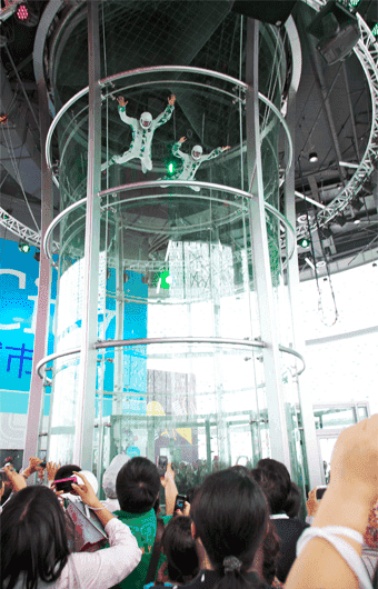

The OP question sounds like these vertical wind tunnel rides.
Eden Hazard said:
2. What would one need to levitate a human (e.g. a foot off the ground) using some type of pneumatic system?
Vertical duct.
Vertical blower.
Man inside ascending vertical airstream inside duct.
Velocity of airstream should be close to terminal velocity.
Please, see:
https://en.wikipedia.org/wiki/Terminal_velocity
:cool:
