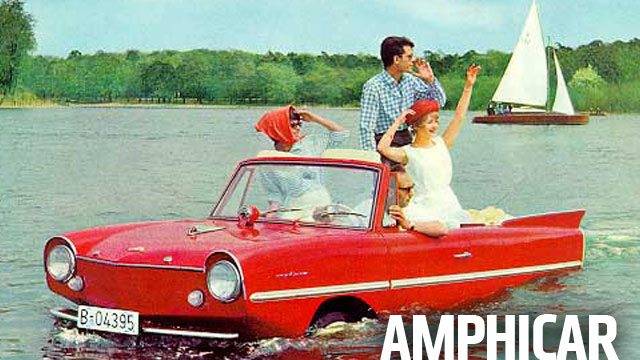

Yes, you;re gonig to have a heckuva time balancing weight.
And keeping it from rolling. It may actually be too buoyant to be stable, and may go turtle on you.
Look how low in the water this amphicar needs to be so it doesn't flip.
BTW, how will you seal big seams like the doors. Lot of pressure there. These amphicars leak like a sieve.

I figured I would conquer weight and balancing when it arose. I was thing extendable arms on each side with floats on them like some sail boats I believe it is has. And for doors... ohh doors. If necessary I will weld the majority of the door shut and make it custom. If i can, what I want to do is look aat the 1990s cj3 jeeps. Which have sealed cabs. I wold borrow some ideas. Also I was thinking. A dam good seal on the door and then a lever that will suck the door in tight against the jam.
