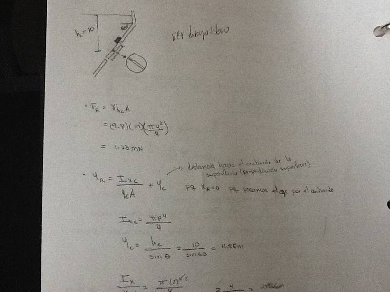

The discussion revolves around the calculation of hydrostatic forces on an inclined plane, specifically focusing on the derivation of the formula Yc=hc/sin 60 and the concept of ratios in this context. Participants seek clarification on the geometric relationships involved and the steps necessary to arrive at the final calculations.
- Exploratory, Technical explanation, Conceptual clarification, Debate/contested, Homework-related
- Some participants express confusion regarding the origin of the formula Yc=hc/sin 60, asking for visual aids to clarify the concept.
- There is a question about the identification of Yc, with one participant inquiring if it represents the hypotenuse of a triangle formed with hc.

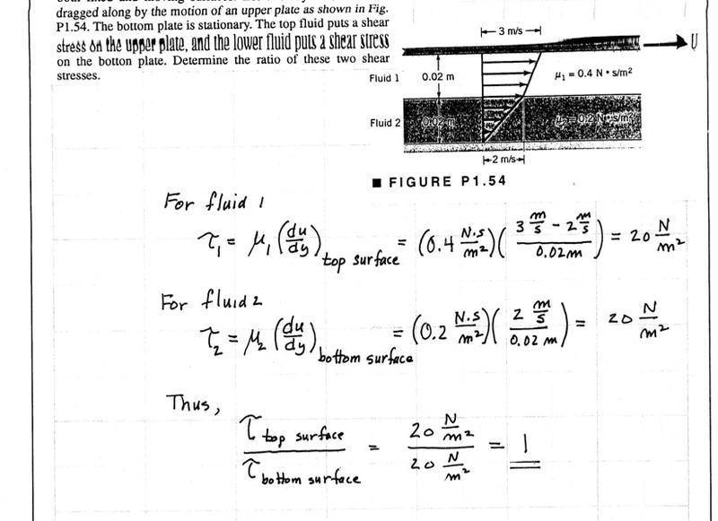

- One participant seeks an explanation for the necessity of dividing two shears in the final step of the calculation.
- Another participant questions whether a ratio is simply calculated by dividing two quantities, which is affirmed by a later response.
The discussion reflects a lack of consensus, with multiple participants expressing confusion over different aspects of the calculations and concepts involved. No definitive answers or agreements are reached.
Participants have not fully resolved the assumptions underlying the geometric relationships and the definitions of terms used in the discussion. The context of the problem may depend on specific definitions that are not explicitly stated.
