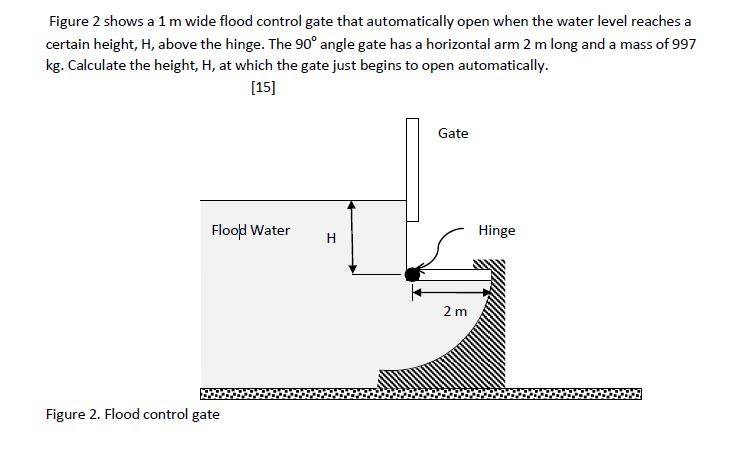

Diagram of a 1 m wide flood control gate hinged at its base, with a 2 m horizontal arm, a vertical gate 90 degrees to it, and water depth H marked above the hinge on the flood water side.
I know we need to use F = pgA(h bar), as that's what I'm given in notes and whatnot, but I can't for the life of me get this simple one done.
Any help would be GREATLY appreciated as I have an exam coming up on this.
It is not that simple. Two questions that might help:
What is the water pressure at the horizontal part?
What is the difference between "does not move yet" and "starts to move", which condition has to be satisfied to not move?

We weren't given any of that info. Just threw this question on us...
This is something you should find out! The given information is sufficient to do so.
You'll also need the density of water and the gravitational acceleration g but those are well-known values.

I'm not sure I understand the diagram. I think the gate is an L shape, but the gap between the hinge and the vertical part bothers me.
Yeah, I think it's drawn incorrectly as well. I mentioned that to the OP in a private conversation we were having, and I probably should have posted it in-thread as well.

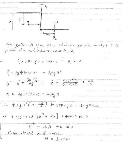

Should have updated this thread, but I've figured it out. Solved it and all! I'll post the answer later tomorrow as I'm about to head to bed for my exam!
EDIT: I just scanned my working pretty quick and snipped it. will post here.
Handwritten derivation for a hydrostatic gate problem: a diagram of a pivoted gate with depth H, offset y', forces F1 and F2, weight W and a 1.0 m arm, followed by moment balance and force equations ending with H^3 - 12H + 6 = 0 and H = 3.18 m.
