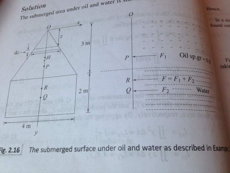

(Referring to attached diagram)
Find the hydrostatic force F2 on the rectangular part and the point of action of this force on rectangular area.
The triangular part is submerged in oil of specific gravity 0.8, while the rectangular part is submerged in water. The whole structure is upright with no inclination with fluid surface.
Hydrostatic force= ρghA, where h=perpendicular distance of centroid of object from fluid surface.
ρ= water density
A= area of surface submerged
According to me:
F2= ρxgx(height of triangle+further distance to get centroid of rectangle)x(area of rectangle)
= 1000x9.81x(3+1)x(2x4)
However the solution in the same book gives
F2= 9.81x1000x(3x0.8 + 1)x(2x4)
I don't understand why 3 is multiplied by 0.8.

Do you have the rectangle submerged in just water, or is there something else on top of the water? Is that something else massless?
Hi SteamKing,
As you can see from the figure I attached, above the rectangle is a triangle submerged in oil of sp. gravity 0.8. So there is basically a layer of oil above the water layer.
Thanks!
What is your equation for the hydrostatic pressure at the base of the triangle?

Actually, I was asking for the pressure at the depth of the base of the triangle, not the force on the triangle.

OK. Please don't mention the word centrioid again. What I'm asking about is not about centroids and areas.
When I say the base of the triangle, what I am referring to is the liquid pressure at the depth of the base of the triangle. The pressure at this location is the same, irrespective of whether the triangle is present or not. It just depends only on the depth of the oil (which, in this problem, happens to be the same as the depth of the base of the triangle).

The pressure at the depth of the oil layer (top of rectangle) is
[tex]p=ρ_{oil}gh_{oil}[/tex]
and the pressure at the depth of the base of the rectangle is
[tex]p=ρ_{oil}gh_{oil}+ρ_{water}gh_{water}[/tex]
So, the average pressure acting on the rectangle is:
[tex]p_{ave}=\frac{ρ_{oil}gh_{oil}+(ρ_{oil}gh_{oil}+ρ_{water}gh_{water})}{2}=ρ_{oil}gh_{oil}+\frac{ρ_{water}gh_{water}}{2}[/tex]
So, now, what is the pressure force acting on the rectangle (finally, this time, you are allowed to use the forbidden word "area")?
Chet
I get it so far.
So the net force on the rectangle is the P_avg x area of rectangle, I think.
Yes.
