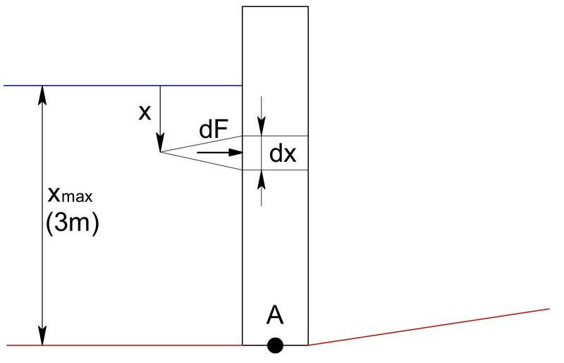

Hello, am i on the right track with this problem. I am not sure if i have done the it correct. The part i am unsure on is b). Not sure if i have calculated it correct.
Part of a sea defence consists of a section of a concrete wall 4 metres high, and 6 metres wide. (See cross-section of the wall in the figure below).
a) Calculate the resultant thrust on the section when the sea reaches a height of 3 metres relative to the base of the section.
b) Calculate the overturning moment experienced by the section about point A.

To obtain the overturning moment around point A you have to integrate the momenta of each pressure force, like
$$\int dM(x)$$.
Any idea how to express ##M(x)## to solve the integral?
now i understand why you done it that way. I don't really have an idea. Do you put 3 and 0 at the top and bottom of the intergral? And x would be 264870?
I attached a small drawing (below the text). It shows the situation with the variable ##x##. At the position ##x## there is small piece of the wall (with the width ##w = 6\, m## and the height ##dx##). The pressure acts on this small area (##w\cdot dx##) and generates a small force ##dF##. This force ##dF## generates a small moment ##dM## turning around point A. But of course the moment is depending on ##x##. Therefore you have to find an expression for ##dM(x)##.
Start with that: What would be the turning moment of ##dF## around point A?

Next step would be to express ##dF## by means of the height-variable pressure, plug that all in into the integral and solve it. Sorry, have to leave. Good luck!
