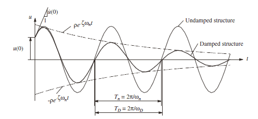

I know that the governing differential equation of a free vibration of a damped system has this form
and its solution (subject to initial conditions) is
where,
, ω_n is the natural frequency and ζ is a damping factor <1 and if drawn it gives
But, the problem here is the third and the fourth terms.
Is it right to just add this term k_2 x to the previous solution?
