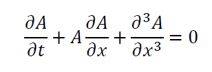

I am trying to understand the resolution of the following KdV equation. I try to demonstrate it by myself.

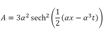

The solitary wave solution is :

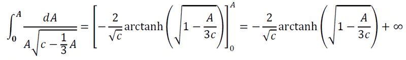

Thank you. I arrived at that with regular substitution. However, I have integration limits problem as I have to integrate from 0 to A. When I evaluate at 0, the arctanh gives infinite... which doesn't help me.

There must be something wrong with the integration limits...
The lower limit in the integral should be [itex]A(0)[/itex]. Now [itex]A = 0[/itex] is a fixed point of the ODE [tex] A'' = cA - \tfrac12A^2,[/tex] so either you start there and don't go anywhere ([itex]A(p) \equiv 0[/itex]), or you approach it only in the limits [itex]p \to \pm\infty[/itex].

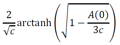

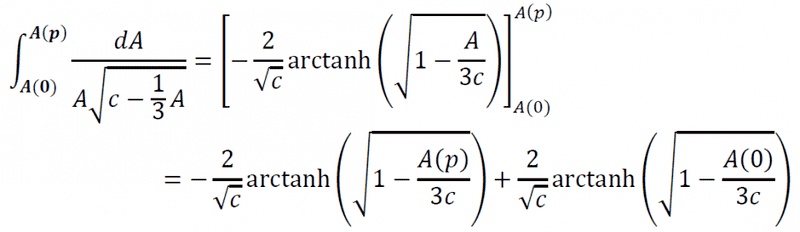

I am sure what to do next about the right term. It should be equal to zero.
The integral is equal to p which was integrated from 0 to p.

I think I got something...
A(p=0) is going to be equal to the amplitude of the solution so 3c => arctanh(0)=0

In full generality, the solution is [tex] A(x,t) = 3 \alpha^2 \mathrm{sech}^2(\tfrac12(\alpha x - \alpha^3 t) + C)[/tex] for some constant [itex]C[/itex]. If you choose to have the peak coincide with [itex]x - \alpha^2 t = 0[/itex] then [itex]C = 0[/itex].
The shape of the wave depends on the wave speed [itex]c = \alpha^2[/itex]; as [itex]c[/itex] increases the peak becomes taller and narrower.

For p, is it correct to integrate from 0 to p? at least it works that way...
