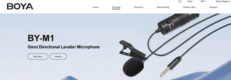

I purchased a cheap lavalier microphone, the Boya BY-M1
Have you tried contacting their Customer Service folks? They have likely heard about this issue in the past, and may have a workaround solution for you (like a ferrite clamp on the cable to the laptop, for example).
https://www.boya-mic.com/product/by-m1
