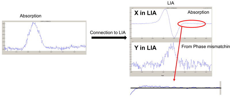

I'm setting up an EPR (Electron Paramagnetic Resonance) instrument and encountering an issue with the lock-in amplifier. I’d like to share the details of the problem and receive any help or advice.

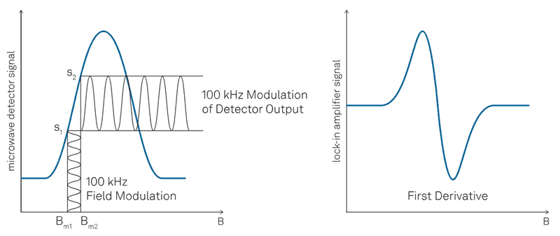

First, I’ll briefly explain the setup. (See Figure 1) On the left side of Figure 1, you can see the data measured without using the lock-in amplifier. When this data is input into the lock-in amplifier, it produces a differentiated form of data, as shown on the right side of Figure 1 in the X channel In a lock-in amplifier, if the phase is correctly adjusted, 100% of the signal should ideally appear in either the X or Y channel. I'm curious why there is still a signal remaining in the Y channel despite these adjustments.. (For a more detailed image, please refer to Figure 2.)
Ref: Zurich Instrument Hompage
This is a very ideal dataset; however, there are slight imperfections, as highlighted by the red circles.

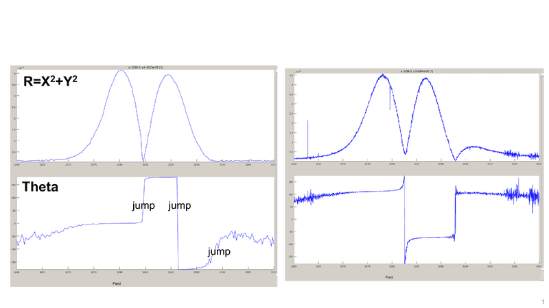

I suspected this issue might be related to the phase-lock of the lock-in amplifier, so I changed the settings to R and Theta for the experiment. The resulting data is shown in Figure 3. In my view, Theta (Phase) should be relatively stable, with perhaps a bit of noise, but the experimental results show significant instability after the first peak. I’m wondering if this is normal data behavior or if it indicates a problem.
Another potential issue I’m considering is that our lock-in amplifier(SRS, Sr830) has a bandwidth of 100 kHz. However, the input to the lock-in amplifier consists of a 100 kHz modulated signal combined with a 100 MHz signal. Can the lock-in amplifier successfully lock onto the 100 kHz modulated signal in this case?

I thought it should remain consistent because, as seen in Fig. 3, the phase during the measurement of the left peak was maintained almost consistently. I expected the phase plot to at least appear as a mirror image on both sides. Of course, I could be wrong.

100 kHz seems very close to the top end of the LIA response, so you might see phase distortion from the LPF at the LIA input. It depends on the sweep speed whether sidebands fall close to 102 kHz. As you are seeing asymmetry I think I would check this.

I have one question. Does sweep speed refer to the measurement speed of the experiment? The right image in Fig. 3 shows results measured by varying the magnetic field strength in smaller steps compared to the left image.

The sweep must be carried out slowly so that the bandwidth is not increased excessively. You have only 2kHz bandwidth available at best, so the sweep probably needs to take more than a few milliseconds. Also it sounds as if the steps are discontinuous, which might generate additional side frequencies which will have to be accommodated by the LIA bandwidth.
