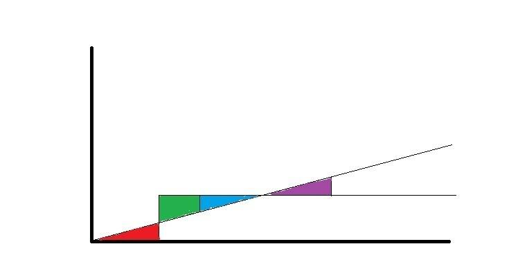

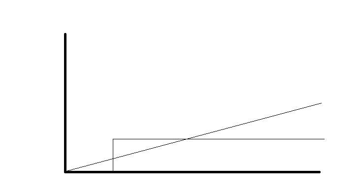

For part (b) , and the double crossing situation, I would start by drawing a velocity - time graph for the pair. [attachment Romeo 1]
Juliet's graph is the sloping line -she is accelerating
Romeos line is horizontal, and starts a little later, since at his speed [5 m/s] he doesn't reach the point from where Juliet started [6 m away] until time 1.2 s.
The consider what happens [attachment Romeo 2].
The red area represents the "head start" Juliet made, before romeo passed her original start point.
The green area represents the distance Romeo made up while he was running faster than the speed Juliet had attained.
When those two area are equal - Romeo has caught - or as is suggested in this example - has run past Juliet.
As more time passes, [attachment Romeo 3] the blue area shows the total distance Romeo gets in front of Juliet before Juliet has reached Romeo's velocity [so he gains no more distance.
The purple area represents the distance Juliet makes up now that she is running faster than Romeo.
Once the purple area equals the blue area she has caught - or is about to pass him ["these star-crossed lovers cross twice].
Now had Juliet's acceleration been greater - her line would have been steeper - then the time at which the green area equaled the red area would have co-incided with the time Juliet's velocity reached Romeo's [5 m/s]
Notice that these graphs were created in "paint" and could just as easily been sketched on paper by you - IF you got into the habit of expressing these problems like this. The velocity-time graph can be a very powerful tool.
From my sketch I can now see that for (b) the maximum value of acceleration is 2.08333333 or 2.5/1.2. Can you see why?

Hopefully attachments - note that I have deliberately not labelled axes or intercepts etc as these are merely "qualitative sketches" to show the concept.
