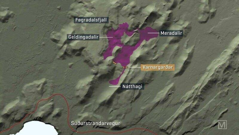

Iceland Volcano Update - New Lava Barrier and Lava Flow Forecast (June 14) - one comment indicates the lava volume estimated at 63 M m3, 0.063 km3. The lava flow seems to be increasing and enroaching on a main road to the south of Natthagi Valley. Essentially, three valleys are getting filled.

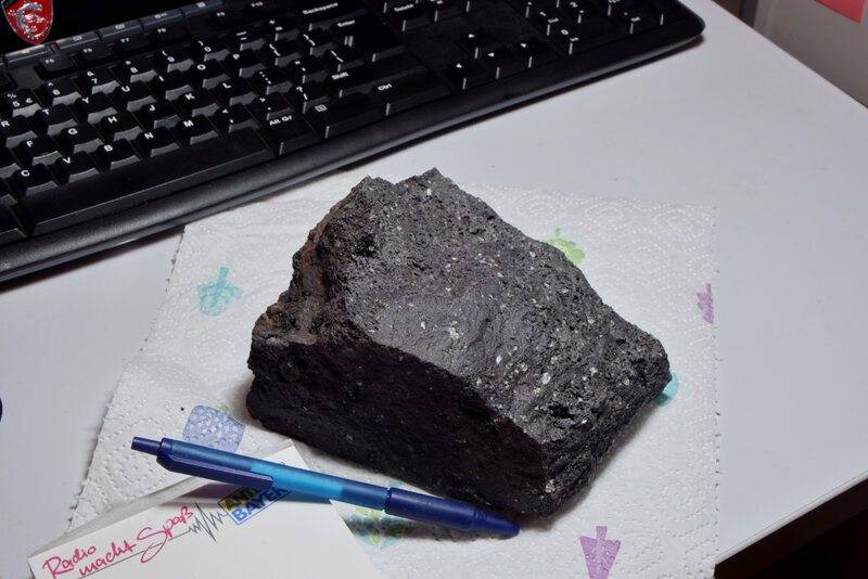

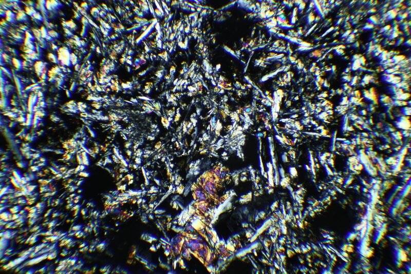

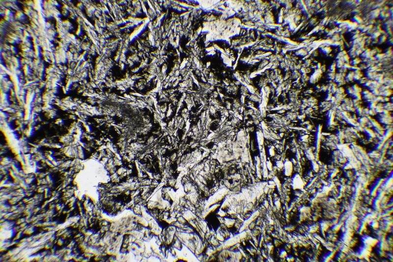

As evenings are getting longer, I found some time to make some thin section slides of the lava which I collected at Fagradalsfjall. It contains long needles of plagioclase (sodium-calcium feldspar), augitic pyroxenes, some olivine and small black cubic magnetite crystals. This is quite what one would expect from a MORB (middle oceanic ridge basalt). The second picture is taken in linearly polarized light, the third one with crossed polarisator and analysator to bring out the birefringence induced colours. The fourth one is at higher magnification.

  • #75
Astronuc said:
So what is the balance? Silica?
Strangely enough I did not succeed in finding some real analyses of the lava or basalt from Fagradalsfjall, So I'll try to present my own layman conclusions.
To begin with, the lava contains certainly little silica, because this would lead to a very high viscosity. If you watch the videos, you'll notice that it flows like water, so viscosity is really low.
This is also confirmed by inspection. The lava contains some olivine which is largely incompatible with free SiO2.
The microscopic analysis shows mainly plagioclase, clino- (~ MgCaSi2O6) and orthopyroxenes (~Mg2Si2O6) where Mg may be substituted by iron, and magnetite (Fe3O4), but no quartz or sanidine (K-feldspar). This is a typical composition for a Olivine-Tholeiite from mid-oceanic ridges, or oceanic islands. https://is.wikipedia.org/wiki/Basalt#/media/Mynd:Basalt_Tetrahedron.png
From some texts on the internet I infer that the magma is very primitive and stems directly from the asthenosphere, which is in line with the composition found.

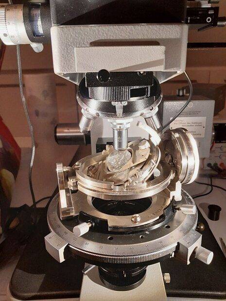

In the debris of the basalt, I found one small splinter of olivine, whose optical properties I measured yesterday on a spindle stage attached to the microscope. Check
https://www.researchgate.net/publication/339054634_steven_guidebook
for a description of the technique.
The olivine has an angle 2V_x between the two optical axes of 89.15 degrees and is optically negative. The axis angle is a monotonous function of the forsterite content of the olivine (W. E. Tröger, Optische Bestimmung der Gesteinsbildenden Minerale, Part 1 Bestimmungstabellen) from which an forsterite content of about 85 % is inferred.
This is quite in line with the values reported for various icelandic basalts in https://academic.oup.com/petrology/article/54/4/745/1548250
which range from 78.1 to 90.2 % Forsterite.
Of course my measurement was made on one crystal, only, so that the statistics is rather poor :-)

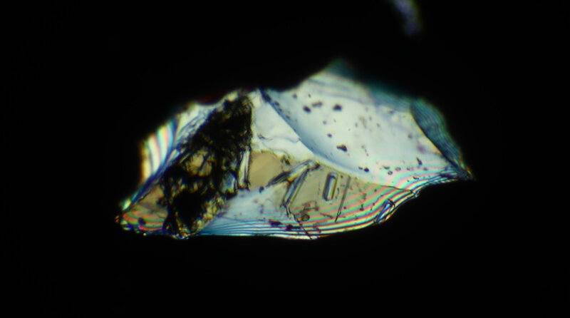

Here a picture of the olivine between crossed polarizers. Note the interference colours due to the strong birefringence.

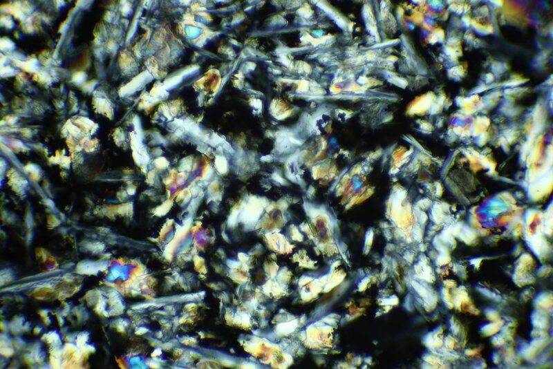

During vacations I found some time to look at the plagioclase in the basalt under the microscope using a so-called "universal stage" which allows to rotate the thin section around 4 axes, see the picture. This makes it possible to determine the orientations of the principal optical axes relative to some characteristic crystal faces.
As these orientations are known as a function of the composition of the plagioclase, namely the albite (NaAlSi3O8)-anorthite (CaAl2Si2O8) ratio, it is possible to estimate this ratio quite accurately without the necessity to do a chemical analysis or a X-ray microprobe analysis. It turned out that the plagioclase is about 95% anorthite, which is what one would expect for a MORB.
In comparison to albite, anorthite contains less SiO2 and is therefore said to be more basic. The low SiO2 content means that the temperature, where crystals begin to form in the lava is quite high, and the viscosity of the lava is low. This is in line with pictures where the lava can be seen to flow like water. The high anorthite content also points to the lava being quite primitve, meaning that it is still quite similar to the primary magma that formed when the mantle material melted.
So quite a lot can already be learned about this kind of rocks without high-tech equipment.
