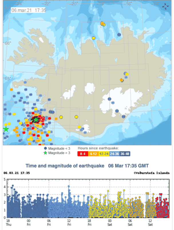

Initially 18,000 earthquakes in a week, then subsequent ruptures in the earth, multiple cones ejecting lava, and now a new volcano, Fagradalsfjall
NYTimes, March 04 - Iceland has experienced 18,000 earthquakes since last week: Volcanologists think an eruption could be imminent in the southwestern part of the island after 800 years of dormancy.
SE corner of Iceland. USGS doesn't show any earthquakes during the last week.
https://en.vedur.is/earthquakes-and-volcanism/earthquakes (mostly less then 2 Mag)
Back in November 2019, an article on the Northern Volcanic Zone
https://advances.sciencemag.org/content/5/11/eaax6642
The current activity in question is in the SE quadrant though. Does this imply a magmatic intrusion in the SE quadrant of Iceland?

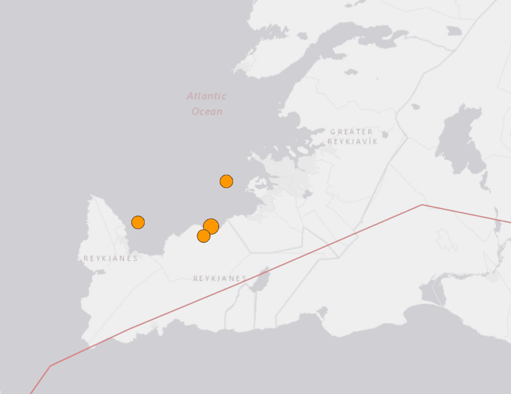

And several earthquakes of Mag 4+. Seems some peak magnitudes are increasing.

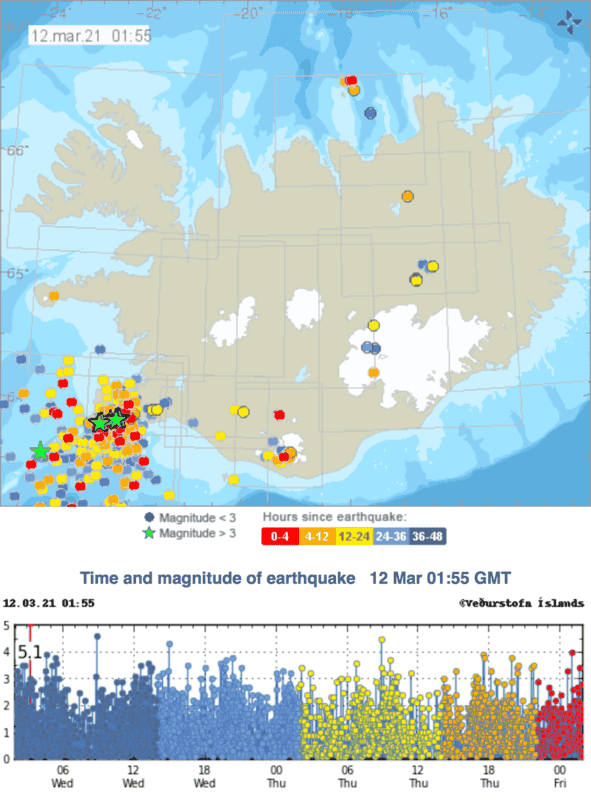

M 4.5 - 8 km ESE of Hafnarfjörður, Iceland
  • 2021-03-14 12:34:38 (UTC)
  • 64.037°N 21.771°W
  • 10.0 km depth
Iceland Met Office reports a 5 Mag. People are being warned to stay away from steep terrain in order to avoid rock slides and boulders that may be loosened and roll downhill.

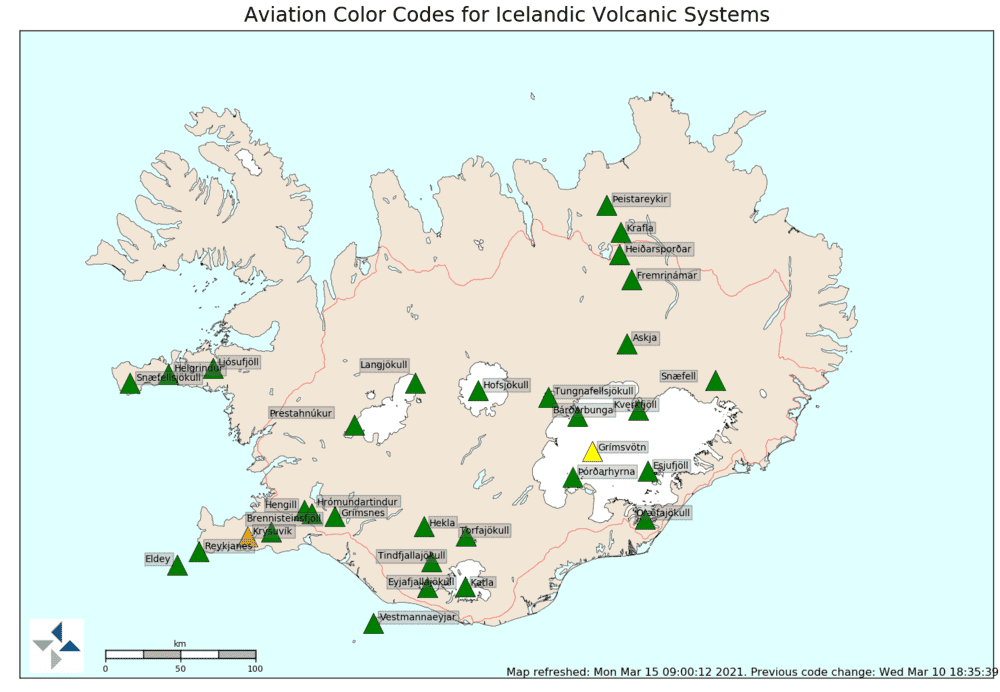

Some recent articles indicated that folks near Reykjavik are losing sleep over the many earthquakes, which apparently is unprecedented. However, the matter has come up in the recent past when earthquake activity increased.
The current activity concerns the Reykjanes peninsula and potential volcanic activity, i.e., magma rising to the surface with a potential volcanic eruption.

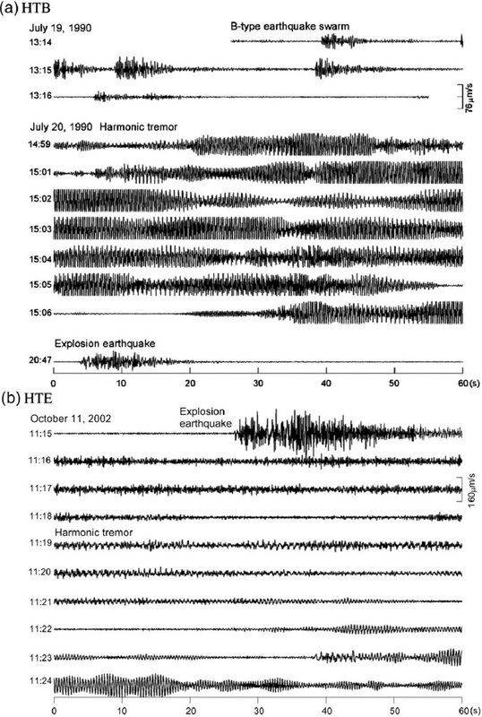

Can the seismograph spectra help us to distinguish strike-slip fault quakes, versus magma movement, versus subsea landslides?
Yes, magma movement doesn't produce P and S signatures, rather it's a continuous signal.
This is called harmonic tremor. will try and find a seismogram of such
EDIT: OK here we go ...

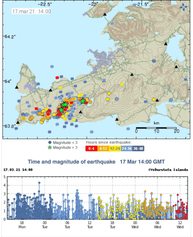

Astronuc said:

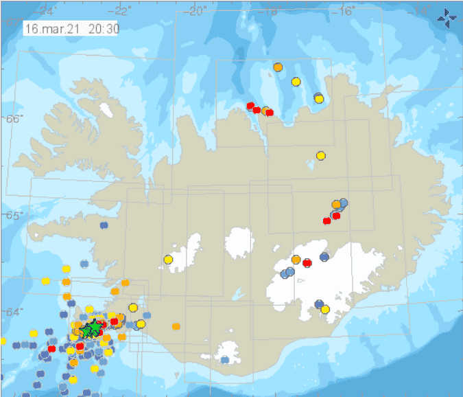

The Icelandic Met Office (IMO) reported that seismicity on Reykjanes peninsula in the area between Krýsuvík, Kleifarvatn and Svartsengi volcanic system has been increasing during the past week.
From the Iceland Met Office,
The Krýsuvík-Trölladyngja volcanic system on the Reykjanes Volcanic Zone has been moderately active in the Holocene (last 8000 years). The last eruptive episode, consisting of two eruptions separated by 37 years, occurred in the 12 century CE, the lava flows reaching to the sea on the north and south coast of the peninsula.
The NE-SW trending volcanic system comprises a 50 km long, composite fissure swarm without a developed central volcano. Maximum elevation is ~400 m a.s.l. The system has no ice cover but a large lake lies within the system.
The characteristic activity is effusive basaltic eruptions producing lava flows covering some tens of km2 and minor tephra deposits. Eruption frequency during the last 3000 years is 1 eruption per 750 years.
The last time Krýsuvík erupted was 12th century CE, so perhaps an eruption is due. Currently, the
Aviation colour code is Orange and Activity level is Moderate.
http://icelandicvolcanos.is/?volcano=KRY# (Click on Catalogue information for details)
https://en.vedur.is/earthquakes-and-volcanism/earthquakes/reykjanespeninsula/#view=map
Interestingly, to the east (SE Iceland) is Grímsvötn. The Aviation colour code is Yellow, but Activity level is High.
http://icelandicvolcanos.is/?volcano=GRV#

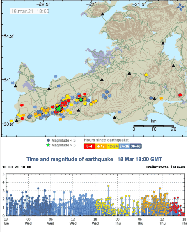

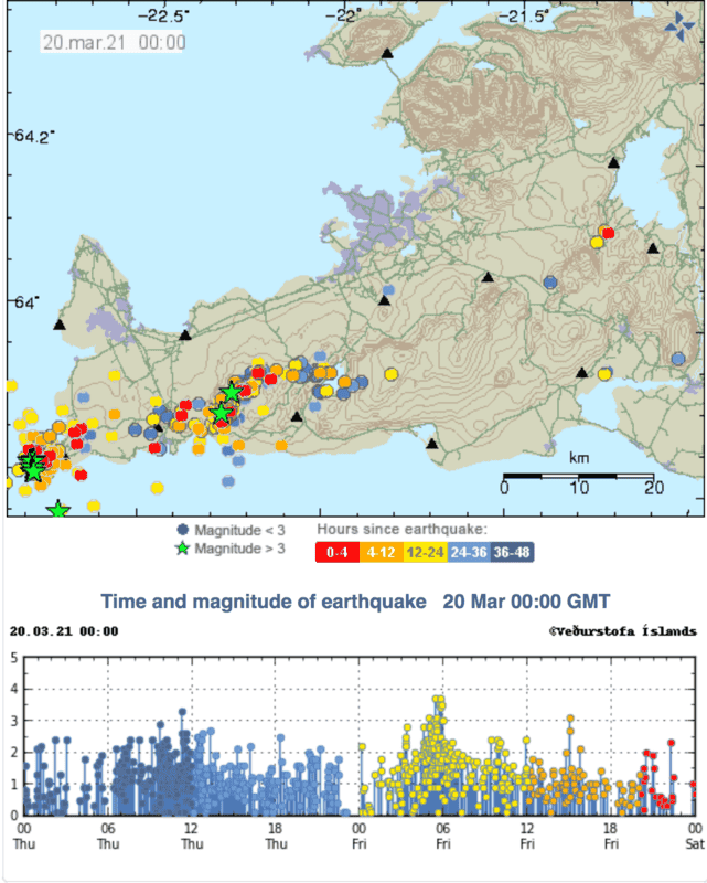

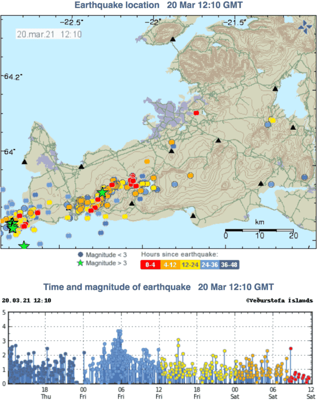

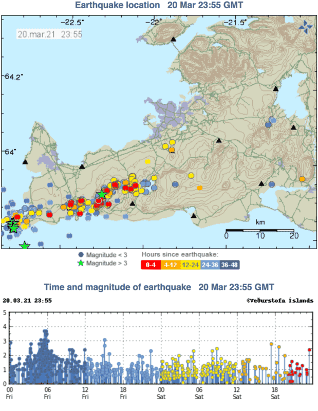

The seismic activity has decreased following the eruption.

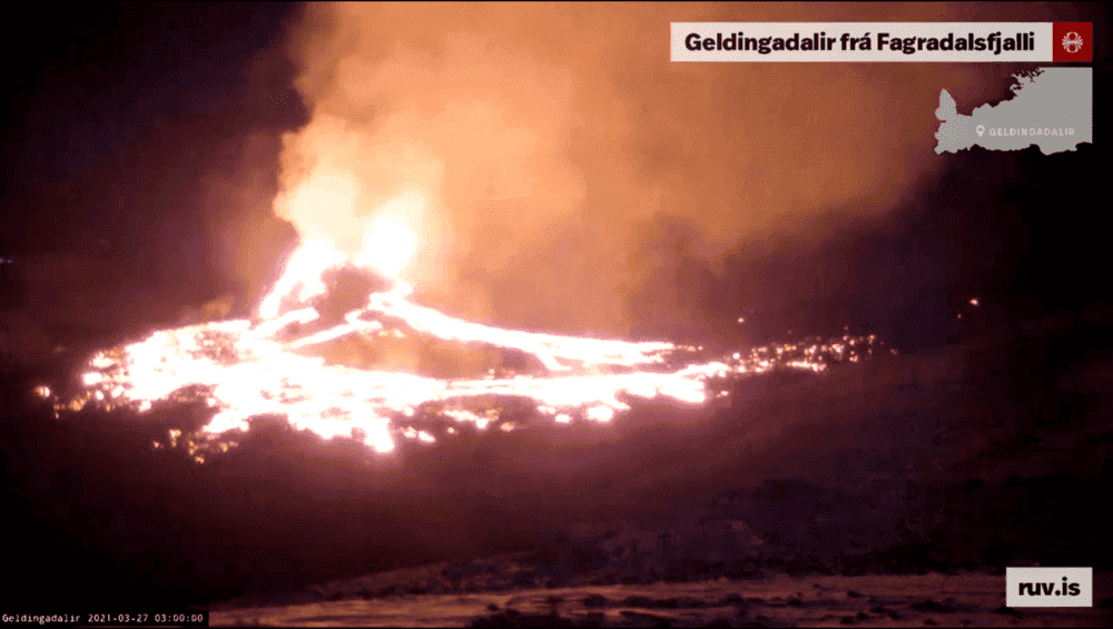

here's the best live cam site I have found for the new eruption ...
(2) Volcanic eruption in Iceland! - YouTube
scroll back some hours to when it was previously daylightEdit, dang ... it's gone offline, hopefully it comes back
I still see the video from the webcam.
An alternative live feed - https://www.ruv.is/frett/2021/03/20/live-feed-from-iceland-volcano
https://icelandmonitor.mbl.is/news/news/2021/03/20/best_possible_location_for_eruption_video/
Edit/update: https://earthobservatory.nasa.gov/images/148079/volcanic-eruption-lights-up-iceland
Yes, it started again overnight, when I got up this morning, it was running again :)
I think Geldingadalur, or whatever they call it, is growing.
I think the webcam on Fagradalsfjall is looking E or ESE, based on a map. So the lava is flowing west, some north, and perhaps some east.

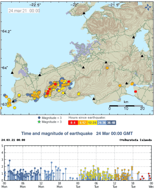

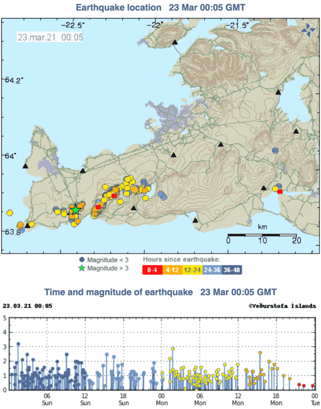

I watched Geldingadalir volcano (it is a new named volcano apparently) during the day. Mid-day through 1815, the eruption activity seemed to have subsided through the day, afternoon into the evening, but it increased by 2000, and is fairly active tonight 0020.
Seismic activity has diminished as well as compared to two days ago.
