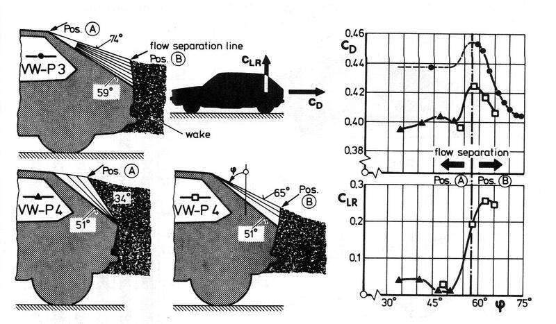

Here's a partial answer from Aerodynamics of Road Vehicles 4th Edition, edited by Wolf-Heinrich Hucho:
The book has a lot more in Section 4.4.5. Details of the transition from roof to back, and from side to back have significant effect on the drag. That book is the standard reference for any person interested in vehicle aerodynamic drag. It's also easy to understand, and I highly recommend it. This is apparently the current (5th) edition of this book: https://www.amazon.com/dp/0768079772/?tag=pfamazon01-20

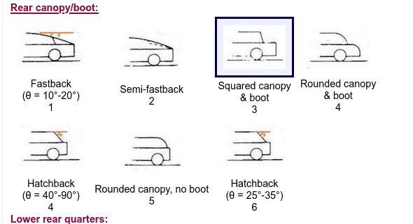

From my site, this is the effect of the rear roofline treatment in order of importance:
Each design adds approximately 0.01 to the drag coefficient ##C_d##. For example, the hatchback with ##\theta## = 25°-35° (design #6) adds approx. 0.06 to ##C_d##.

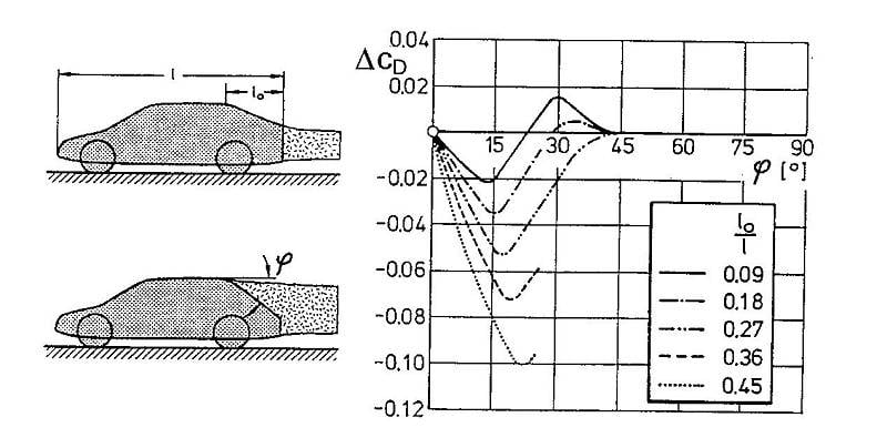

What is delta Cd, why Cd has minus and plus sign, can you describe this graph?

I think design 5 has highiest drag, round edge cause low pressure point here.
If better look modern cars have sharp edges at side and top where air leave car,you must avoiding low pressure peak.
Also I think in hatchback where flow separate from back, rear window angle don't change nothing, because flow is allways separated, if angle is 40° or 80° is the same...
What is book description with second graph?

Why Cd is negative, can you explain what this graph show
You really need to read the entire section in Hucho to properly understand it. There are other graphs in there, and text explaining everything. That book is necessary if you are truly interested in the subject, although there might be other vehicle aerodynamics books that are as good. If you are not interested enough to buy a copy, borrow one from a library.
That graph is based on a simplified model. The more detailed information in the book also discusses the effect of important design details at the side corners.
You need to spend time studying the graph. First, look at the horizontal axis. It's the angle ##\phi##, which starts at zero. When ##\phi## is zero, the model is a simple squareback. The various lines in the graph represent different lengths of the rear taper. Those lengths are expressed as a ratio to the overall length as shown in the top part of the sketch and in the block set inside the graph.
A taper angle of zero is a simple squareback, and has an overall ##C_D## of whatever it is. The vertical axis is the change of the ##C_D## from that baseline ##C_D##.
Now is clear.
Inerestly for some high AoA angles for lines 0.09 and 0.18,drag even worse than squareback.
So longer the rear=better (0.45 line), at 20° "AoA" Cd start rise, probably flow separation start.

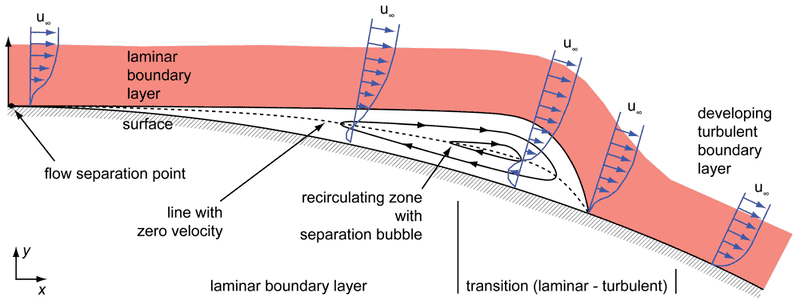

Does flow separation induce low pressure or high pressure at the rear window+trunk compare to attached flow?
Attacehd flow is faster so this mean low pressure, hmm but we don't wont to have low pressure here,
goal is to increase pressure at the back of car as much as possible ...?
So we can deliberately stall rear window/trunk to decrease drag of car?
Flow separation creates a low pressure zone that is pulling the car backward.

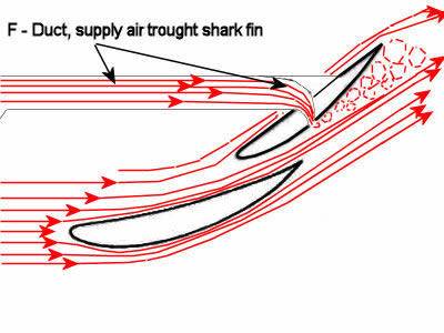

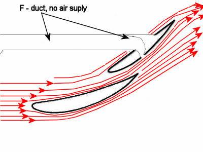

(But how then F-duct system reduce drag at F1 car if stalling the wing reduce pressure at back side of rear wing?)
I don't know the system, but it seems the duct as a whole is blocking the flow to the rear wing, thus the wing is in the turbulence behind the duct, which is not good. At higher speeds, they divert part of the duct flow to go straight through, effectively reducing the duct frontal area and creating a more laminar flow for the wing. But I might be mistaken.
Here is some explanation how this looks like:
https://formula1techandart.wordpress.com/2010/12/14/mc-laren’s-innovative-rear-wing-system-f-duct/
https://www.formula1-dictionary.net/f_duct.html
I see now.

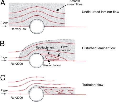

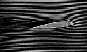

First, you should accept that creating lift will most likely create drag because there is no free lunch. Therefore, by reducing lift, you should expect the drag to drop.
The drawings in your post show the streamline going upwards, ending with a simple arrow. I highly doubt that this is what actually happens, especially at high speeds. The streamlines must come back down and that will be turbulent. By creating the extra turbulence, you are effectively altering the top wing shape by thickening it. The middle streamlines are therefore diverted to a more horizontal flow - themselves pushing down on the lower streamlines and pulling the top ones down - thus less turbulence overall is needed to bring back the entire flow horizontal. This decreases the pressure drop, leading to less downforce and less drag.
In the following images, do you see how the shape of the turbulent flow tends to create another horizontal "drop shape" to bring back the streamlines horizontally?
If you would create turbulence in the middle of the wing, it would pull the top streamlines down, leading to a smaller "drop shape", close to the wing shape. We call that reattaching the flow. Here are other examples:
Link Removed
s-from-a-CFD-simulation-demonstrating-the-recirculation-region-and-reattachment-length-Lr-in-a-pipe-with-a-sudden-expansion.-Source-Carrillo-et-al.-2014.png
