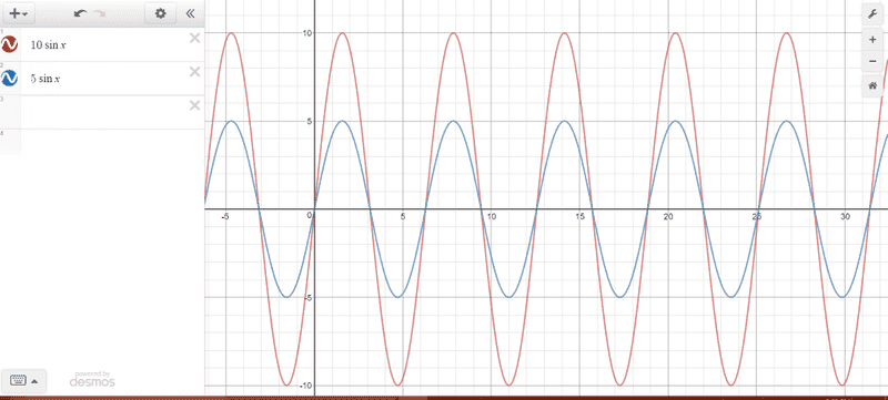

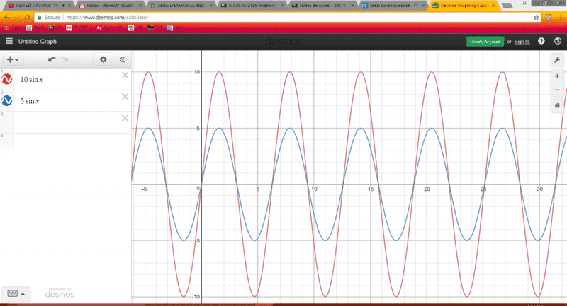

Would it look something like this?
No. That doesn't show the action of the diode. It looks like a "pure" voltage divider, affecting the whole input waveform equally.
Edit:
However, if you choose the appropriate portions of both curves using the conclusions you've drawn earlier, you should be able to piece together the entire output signal.
