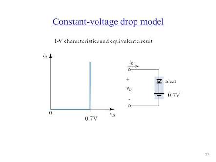

I am practicing problems like this:
where Vs=10V, R=2kohm, they say it is like a battery + ideal diode with VD=0.7V
I have to sketch the transfer characteristic Vo=f(Vs) and draw the waveform of Vo(t)
I am really unsure how to go about these problems. I have the answer, I just don't know they got to it. Can someone explain please?

So, your dc source is variable, say from 0V to 10V. The diode drop is assumed to be 0.7V. What can you say about the i-v characteristic of the diode from this? Can you plot the diode voltage first, as a function of the input dc voltage?
Now for input voltage Vs≤0.7V, what is the diode voltage? For Vs>0.7V, what is the diode voltage?

We are talking about "voltage" across the diode. If Vs=0.5V, what is the voltage across the diode? Use the above graph. You are right about Vs>0.7V.

Ok. We can work that out here. We will take the voltage source as AC, with magnitude 10V.
What is the volage across the diode when Vs<=0.7V? Refer the graph in #10. Once you know that, you can draw the transfer characteristic easliy.
Or answer this: If Vs<=0.7V, what is the voltage across the 2k resistor?

There is still the resistor.
At V0=-10 V, analyze the circuit. What is the voltage at the resistor?
At V0=-5 V, analyze the circuit. What is the voltage at the resistor?
At V0=0 V, analyze the circuit. What is the voltage at the resistor?
At V0=+5 V, analyze the circuit. What is the voltage at the resistor?
At V0=+10 V, analyze the circuit. What is the voltage at the resistor?
With those values (and suitable intermediate values), you can plot the voltage at the resistor as function of the source voltage. That is the curve you need in the first part.
