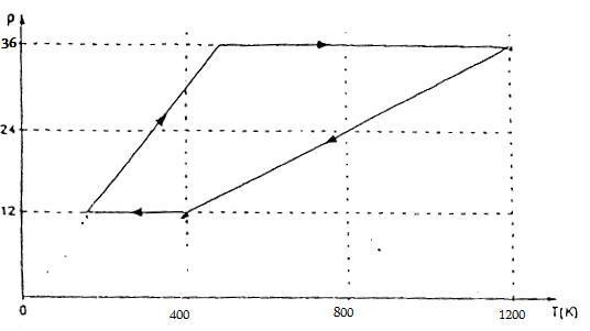

An amount of ideal gas undergoes the folowing cycle process in the following graph:
P-T graph of a closed cycle for an ideal gas: pressure p on the vertical axis (marks 12, 24, 36) against temperature T in K on the horizontal axis (marks 400, 800, 1200), with arrows showing the direction of the process.

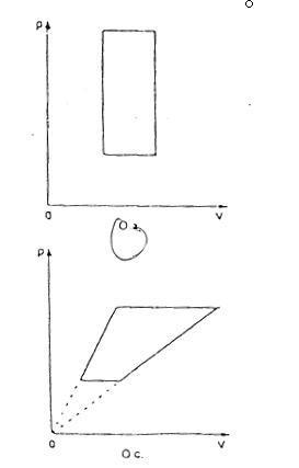

This process can be presented by the following PV-graph :
Two P-V diagrams with axes p and V from origin O: the upper one shows a closed rectangle, the lower one shows a quadrilateral with dashed lines back to the origin, and a small loop labelled O between them.
The answer has to be the upper graph but why can't it be the lower graph ?

  • P-T graph of a closed cycle for an ideal gas, pressure p on the vertical axis (marks 12, 24, 36) against temperature T in K on the horizontal axis (marks 400, 800, 1200), with arrows showing the direction around the loop.

  • Two pressure versus volume (p-V) graphs: the upper one shows a rectangle, the lower one a skewed quadrilateral with dotted lines extending back to the origin O; a small looped cycle diagram on the O-c-p-V axes sits between them.
An ideal gas has: p V = n R T
That is: V = n R T / p
As you can see in the upper graph there are linear relations between T and p, meaning V must be constant, resulting in vertical lines in the p-V-graph.
Note that the diagonal lines in the upper graph can be extended to intersect the axes at the origin.
