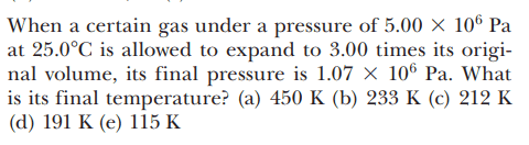

However, why must we use absolute temperature for the ideal gas law (i.e why can we not use Celsius for T)
Many thanks!

The ideal gas law needs to consider ratios of temperatures under different conditions. If you use either C. or F. then you have this choice of origin. If you changed the origin you could get different results for the same physical situation. For example, suppose you arbitrarily invented the ChiralSuperfields temperature scale, which was just the Celsius number plus 10. If you used the ChiralSuperfields temperature scale in the calculation, you would get different numbers when you took ratios of temperatures. The same exact situation would give you different results. That is clearly wrong.
Only choosing a temperature scale with its origin at absolute zero will let you avoid that. That is because absolute zero is a physical thing. One aspect of how it is physical is, it's the temperature that works for the origin of the temperature in the ideal gas law.
The size of the degree in these two systems is different. That does not matter. It only changes the units of the results you report. The R in PV = nRT also has units, so you only need to get the value of R in the other units. Or, if you are doing ratios of temperatures the units will divide out.

While the explanations about the meaning and usefulness of the Kelvin scale are probably useful for the OP, they seem to imply that the Kelvin scale is required for the gas law. The answer to the OP should be that the law as is written assumes temperature in Kelvin scale and this is why you need to use the temperature in Kelvin scale. If it were written for other system of units, then you have to use these units. So we need to use these units simply because the formula was devised for these units. But the law can be formulated for any unit system. Actually, one of the first formulations (if not the first) by Clapeyron in 1834 does not mention the absolute scale. The formula he gives is ## pv=R (267+t) ##.
And same is true for any other formula. If you want to get the force in newtons from newton's second law written for SI units, you need to use mass in kg and acceleration in m/s2. But there is no deep meaning of using these units. If you want to use other units you just have to use the formula devised for that system of units.
