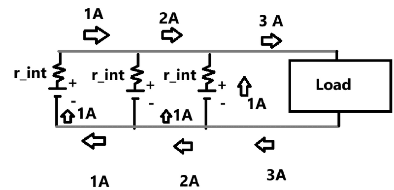

If I have three identical cells. Fully charged. Same age. Charged and discharged the same amount of times. Each cell has the same internal resistance ##r_{int}##. Lets say they are connected to a load that draws ##3 A##. I'm reading that each cell would draw the same current ##1 A##. Something like below:

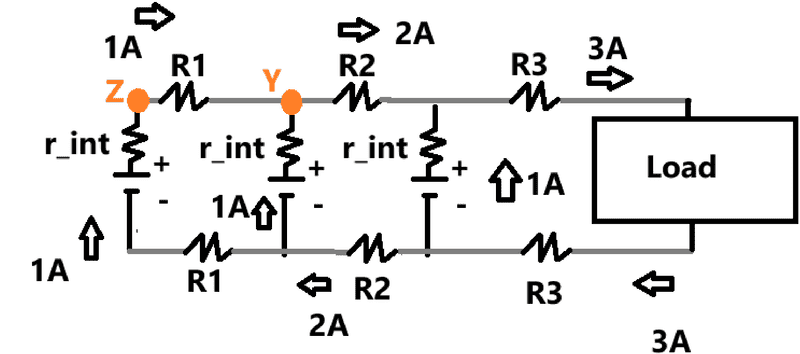

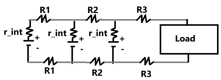

Is this true though if I consider the resistance in the conductor? Say the top and bottom conductor are two separate identical conductors. The top conductor is a single nickel strip with width ##W##, thickness ##t## and length ##L##. This single nickel strip is placed across the positive poles of the three cells and to the load. Something similar is done for the negative poles. Consider that the distance between the first cell and the second, as well as the second and the third, is the same displacement. But the length between the third cell and the load is some other length. Now I can calculate the total resistance of the top conductor easily.
$$R = \frac{\rho\;L}{Wt}$$
Is it possible to calculate the values of R1 R2 and R3? If say for example I know that the cells are 3.7 V? I'm seeing some problems with assuming that each cell draws 1/3 of the current or 1A, like below.
The voltage at Node Z must be
$$3.7\;V - (1\;A)(r_{int})$$
But wouldn't this also be the voltage at node Y? If the nodes are at the same voltage, than there is no current flow between nodes Z and Y. So I'm wondering how do I model this circuit, and what I'm doing wrong exactly?

When you include the conductor connecting the batteries the batteries are really not exactly in true parallel where node ##Z## and ##Y## are at the same potential. Think, if there is current flowing through ##R_1## there is a potential difference across ##R_1##. How then can ##Z## and ##Y## be at the same potential?

In your lower picture ##Z##,##Y##, and presumably##X## are all at the same potential because you are assuming a conductor that joins them of zero resistance...in practice it just a very large conductor (negligible resistance) in comparison to other resistances in the circuit.

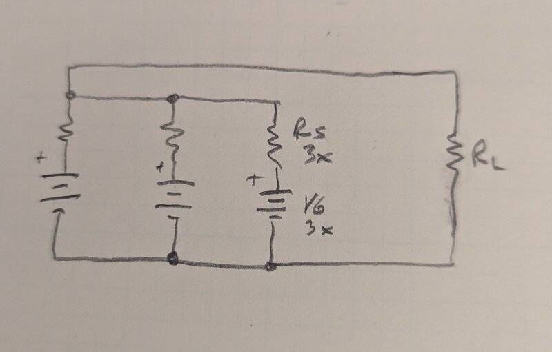

This current sharing problem is well known in high current or low impedance circuits. In my case, a capacitor discharge network into a flashlamp (something like 1.2KA in 100-200usec, IIRC). The standard approach is to wire the load as shown below. Try to repeat your analysis with the conductor resistance in this configuration to see why we do this.

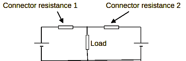

To add to what's already been said, consider the simplest case of 2 batteries (or, more correctly, cells) in parallel.
Look at the following diagram (internal resistances omitted for simplicity).
'Connector resistance 1' is the total resistance of wires/strips connecting the left cell to the load.
'Connector resistance 2' is the total resistance of wires/strips connecting the right cell to the load.
Consider the symmetry. You should see:
a) If the connector resistances are equal, the currents through the cells are equal.
b) If the connector resistances are unequal, the currents through the cells are unequal.
