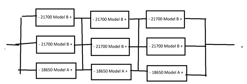

Mix 21700 and 18650 cells in parallel?
I'm doing a 3S3P pack. My box can hold 9 18650s. It can also hold 3 18650s and 6 21700s. Is it ok to mix 18650s and 21700s in the same p pack? I would use the same 21700s and the same 18650s in each p pack. I would arrange them to maximize capacity.
So say 18650 cells are Model A cells (making up model number her for discussion purposes). All 3 18650 cells in my battery be model A.
The six 21700 cells are Model B cells.
One P pack would contain 2 model B 21700 cells and 1 model A 18650 cell.
I make three of these identical P packs described above. I would then put these P packs in series to create my battery pack.
Good idea? I don't see any issues. Each P pack would have roughly the same capacity and max current draw as each other (each cell slightly different even from same model) and would be identical.

So physically, due to higher energy capacity, I figured option 2 would be the most optimum solution, and then I asked myself if combining cells of different sizes into a parallel pack would be a good idea or not. I would do a 3S3P configuration. Meaning I would have something like this:
1) If I had in parallel A-A-A my overall capacity would be 9 Ah, maximum continuous discharge current of 75 A
2) If I had in parallel A-B-B (shown in the picture above) my overall capacity would be 10 Ah, maximum continuous discharge current of 85 A
3) My container will not fit this If I had in parallel B-B-B my overall capacity would be 10.5 Ah, maximum discharge current of 90 A
I do suffer .5 Ah capacity and 5 A maximum discharge current, by not using all the same 21700 cell from the same manufacturer (Option 3), nine of them. But if that's all I suffer, is capacity and maximum continuous discharge current, and I'm willing to take those losses, than is that ok? Because in the end I still have a battery pack going with Option 2 over Option 1 (and my container won't physically fit Option 3)?
I would need a BMS in there (not shown) to have charge balancing. Each parallel pack would be the same configuration A-B-B. So each parallel pack/string would be the same.
I know that I shouldn't have in parallel batteries with drastically different voltages for long periods of time. That's a big "no no". Although people do try this to revive dead batteries, probably not to safe, creates a lot of heat I believe. I see that the nominal voltage of 18650s and 21700s is the same, so as long as I fully charge them than I think I should be ok on that front.
I know the capacities and maximum discharge current would be different, but I think I would be ok if I arranged them in the configuration shown in the picture above, each parallel pack of same configuration? Each instance of say the B cell would be slightly different. One could be 3502 mAh while another could be 3498 mAh. I would obviously do capacity matching, such that the overall capacity of each parallel pack was as high as possible, getting the optimal capacity.

I think this is a terrible idea.
When you start out, and everything is putting our 4.2 V, no problem. Then as the batteries discharge, the two different kinds of battery have two different voltages. And you have them in parallel.
The only way to 'safely' do this is to de-rate the cells (by a lot). That would seem to negate any 'capacity advantage' that might be had.
@YoshiMoshi I am curious as to your background. You've said that you are an electrical engineer in the past, but this design seems to have far, far more disadvantages than advantages. Including safety issues.
I would expect a EE to stay far away from this design.

I see what you guys are saying. It does seem unsafe to me. I see lots of people on YouTube though, that "salvage" 18650s from old laptop batteries, and add them in parallel to their power wall. I thought that was a bit interesting. I see people claiming it's no problem adding 18650s in parallel with other 18650 cells, different manufacturers and models, different brands. Is this wrong? Which I don't know if that is necessarily true or not. That's when I then asked the question, under the presumption that is true and safe to do, then what's wrong with mix matching 18650s and 21700s in the same battery pack?
I think ideally cells in parallel is like forming one giant battery, were the currents add up and capacities. Maybe that's not a good way of looking at it "one giant battery"

A WELL DESIGNED battery pack can be viewed by the user as "one giant battery". To the EE that designed it, it's a network of small batteries. The only easy way is to match cells as exactly as you can, including testing and discarding outliers of the same type. There is a lot of information on the web about this standard application. It sounds to me like your in over your head here.

I think this is a bad idea because DIY battery packs first need to test the capacity, internal resistance, and other parameters of batteries of the same model, and then reassemble batteries with similar parameters to avoid possible malfunctions during charging or use.
In view of this, my suggestion is to build two different types of battery packs separately (such as the 3S battery pack built with 18650 batteries); Secondly, when using multiple battery packs together, add Schottky diodes to prevent current reversal; Finally, charge the battery packs separately during charging, so that both your charger and electrical devices can be shared, making it easier and more convenient.
