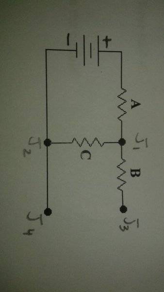

Identical bulbs, rank by brightness

Which bulb(s) will have the higher light intensity?
Resistors:
Connection in series: same current
Connection in parallel: same delta V
A and C are in series. They'll be equally bright. B is not connected to the negative terminal of the battery. no current will pass through it. Hence A=B>C

well, what do you mean by it? What it says to me is very literal, A equals B and either both are greater than C or at least B is greater than C. I don't see how you get that from what's going on. Do you mean something else?
I mean that A and B are equally bright and that both are brighter than C
Yes, that's what I thought. Is that really what's happening?
Sorry, I was confused. I meant A=C>B. Also, is there any current passing through B at all?

I think there's no current passing through B at all. My reasoning: why would the electrons go through path with a resistor that does not lead to the negative terminal of the battery when they have the choice to take a resistless (ideally) path that leads to the negative terminal of the battery.

Your answer is correct. Have you studied what an "open circuit" is?
Not yet, but I am curious. I'll look it up. Is it when there is a gap somewhere on the circuit so the current pass? What is it useful for?
It is the technical term for a "gap" in the circuit, so current can't flow through it.
A circuit needs to be closed for the flow of current. Here, no current flows through bulb B since there's no closed path.
